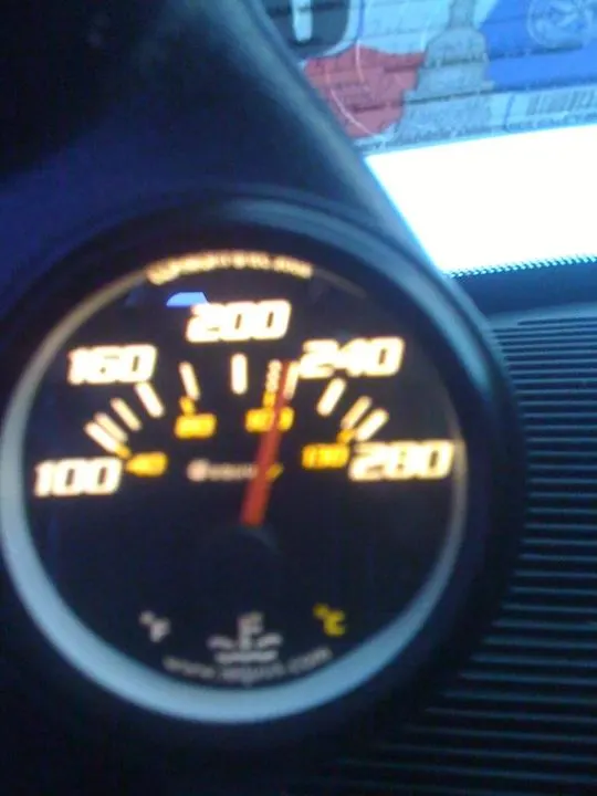

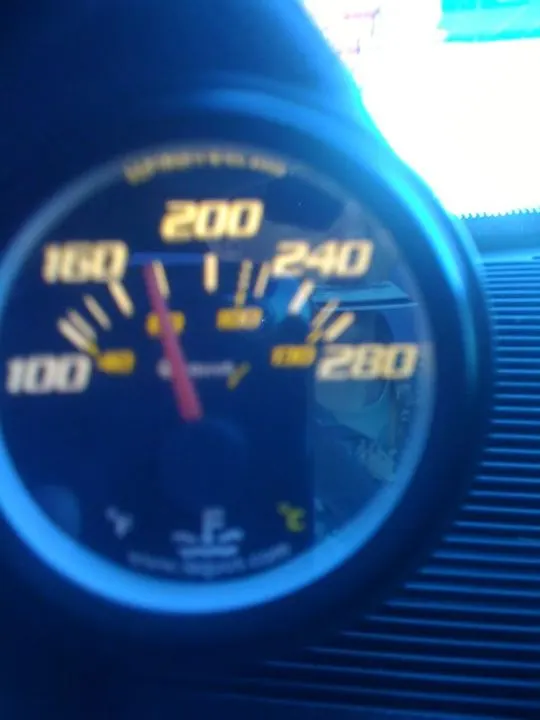

What baffles me is in the morning it takes a good 10-15 miles to get up to 200*, but the weather is in the low to mid 50s and the car runs right about 180*. If I went longer it would probably still go up to 200* and more. In the Afternoon when I go home going the same distance and speed the temp takes like 5-6 minutes to reach 180* and will slowly go past 200* to around 220* in high 60s low 70s weather. If I sit at idle it will go down in the morning slowly a bit and in the afternoon it just stops going up if I'm idling. Should I keep the 180* or go with something cooler like a 160* (summers are in the high 90s low 100s here) or a 192(5)*?
Also...could my thermostat be stuck open? I do know that this thermostat has a bypass hole in it that's very small.
Morning:
Afternoon:
You are probably thinking why am I worried? I'm worried because if I go farther it will possibly overheat and also it should run cooler.

160s = bad. Provided your cooling system is up to snuff (and it sounds like it isn't), your car temp would hover BELOW the tempurature required to put your EEC into closed loop. Another potential problem is that oil may not be thorooughly heated to operating tempurature keeping it from catlyzing (read: sludge).
180 is as low as you should be going on a street car.
Something else that comes to mind is that switching to a lower t-stat is not going to gain you anything. If your cooling system is not able to remove the necessary heat from your motor at 180* then it's going to be even LESS efficient at removing heat at 160*.
If you're getting rising temps at cruise and cooler temp at a stop then you're not getting the necessary air through your radiator. It's pretty much that simple. The low air pressure area of your engine bay should be behind and below your radiator. That's what that little air dam is for. The high pressure area should be infront of and either above or below or both, from your radiator.
I see from your avatar that you have a hood with a scoop on it. For sh*** and grins, try plugging that hole and go fro a cruise. If that is an active air vent then you're putting positive air pressure inside of your engine bay and probably equalizing the air pressure from the rear of your radiator with the air infront of it. I'll bet a nickle that just plugging that hole will make a difference. A more permanent fix would be to put a decently sized airdam underneath and just forward of your radiator mount.
Give it a try.

Quite possibly the best way someone has analyzed my problem thus far. I've been searching for the problem for a loooong looong time now (October 09). I did however get a 180* T-Stat. Do you recommend me going to a 195*? I plan on buying the air dam for under the radiator from LRS. Also how would you recommend plugging the hole(s) as I have the Ram Air cut out and the vents from the rear cowl?
