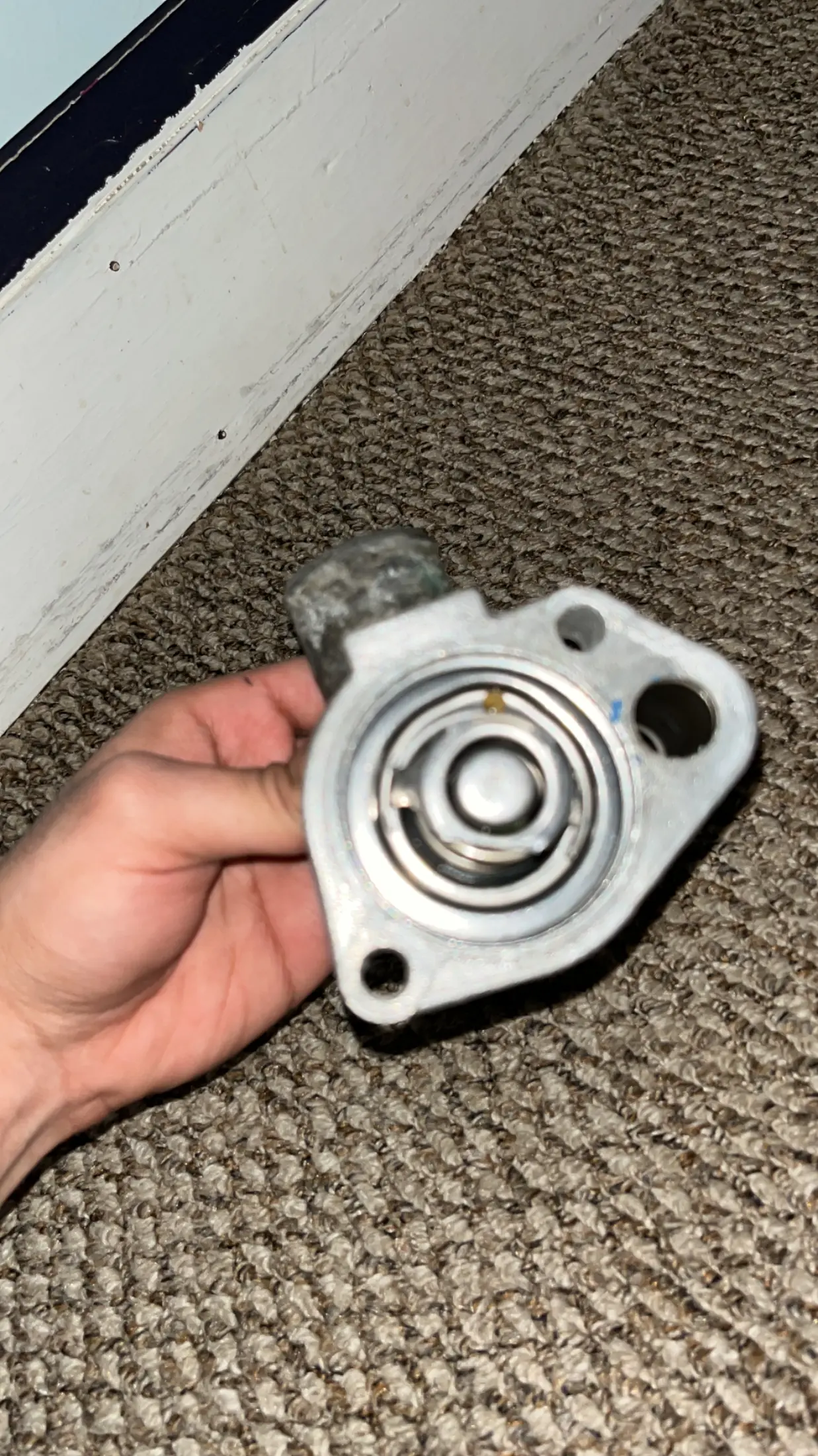

Did you install the t-stat in the correct direction? Pull the t-stat like Limp said and you can also put it in a pan of water with a thermometer and see when and if it opens by heating the water on a stove.
Is air in the cooling system a possibility? I tried a new thermostat that opens when it should and the car is having the same issue. The upper radiator hose was still cold at operating temperature. Obviously coolant has a circulation problem. I have ran the car with the radiator cap off but can air still be stuck in the system? Mind you I didn’t jack the front of the car up while burping the system and I haven’t seen coolant rise up at operating temperature like it normally has previously.

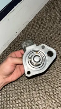

I typically drill a 1/8" hole in the flange of the t-stat and put that at the 12 o'clock position when it is installed. This will burp just about all the air out of the system. Some t-stats have a built in bleeder but I have not installed one to say whether or not they work as advertised or not. This is not my picture but you get the idea:
I installed one also with the hole already there. Do I rule out trapped air completely then?
