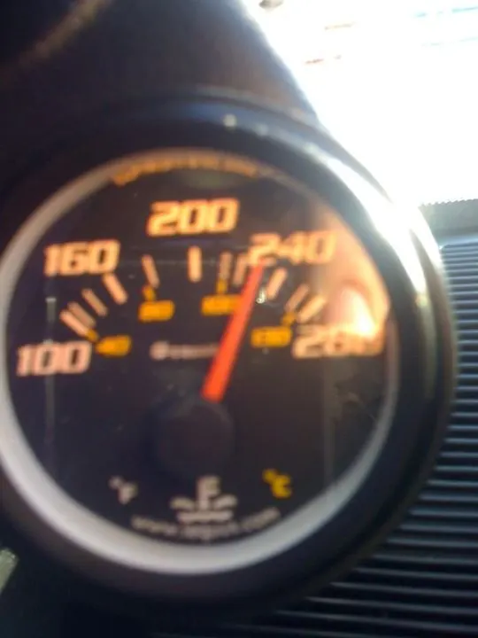

Here is an update .. Removed the old T stat it was stuck open .. put new one in and now it gets hot faster and is actually bubbling out .. I'm thinking this one may be stuck closed it's a stant too grrrr any Ideas or u think I may have a bigger problem?

Did you test it in a pot on the stove before installing? I always do this to ensure that they open at specified temp and open and close properly. Sometimes you can buy bad ones as said in an earlier post. I bought a new stat today (Mr. Gasket Balanced 180*) and I tested it in a pot of hot water and it opened right at 180* and started closing at 179*. It's all about luck lol.

Well I drove a little farther today in low 70* weather all highway (around 15-18 miles) and the temp gauge went up to around 228*-230* and pretty much stayed there for about 6-8 miles of the drive.
