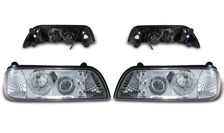

these 6 pc lights are a PITA...how do you aim these things?
If you're talking about these:
then there is no aiming provision. You get them the way the Chinese 12-year old girl made them.
i guess ive never needed to :shrug:

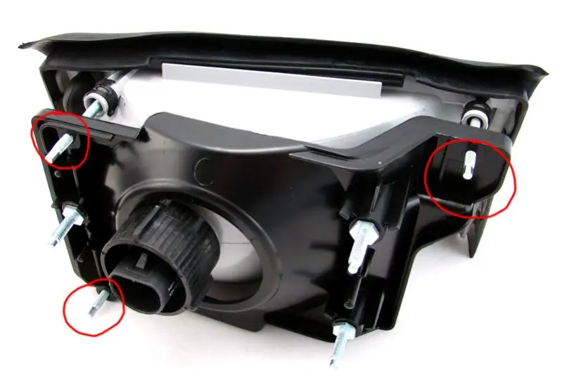

so the hex studs..so you have to take the bracket off the back of the light to adjust the screws? i dont see how else you would adjust the studs? and yes 6 piece smoked factory style lights from
50resto.com
50resto.com
The studs stick out of the header panel about a half inch. You just turn them with the appropriate sized socket.
