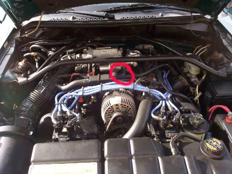

This is where I put it, I remove the black hose from the plenum bung then I insert some 1/4" tubing loosely into the bung, then I stick the other end of the tubing in the SeaFoam while the wife keeps the RPMs up to prevent the engine from dying, as soon as it is all sucked in I kill the engine and wait about 10 minutes. After that it is time to take it for a drive :banana:

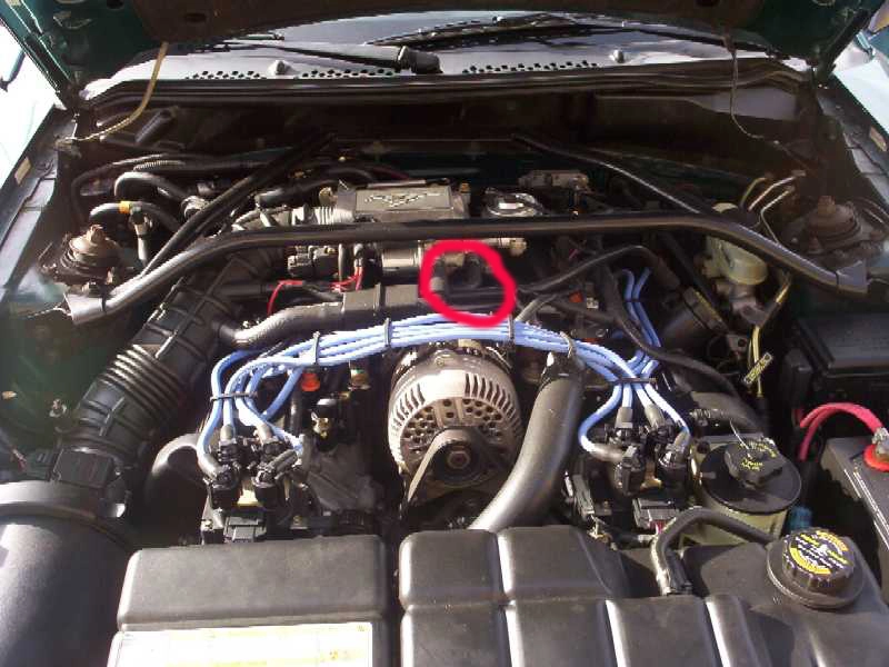

HAHAHAHAH :rlaugh: ok sooooo lets go over this again.
Killgore, you say the YELLOW circle is the line that is the PCV, and the line you used to put the Sea-Foam into?? Well the 2nd i unplugged that, the car died. And i was like "way to go killgore" and just started laughing lol
So did i do something wrong already? lol or is this NOT the line you were talking about??
Red Circle: What is this vacuum line? Can i connect a hose to THAT line (going into the intake end of course) and suck the Sea Foam through there?? What the hell line is this?
Yeah, that's the hose it should go into. It should run to your passenger side valve cover. You need to have someone keep the rpm's up while you're feeding the seafoam into the engine. Never heard of anyone using the hose in the red circle, though.
