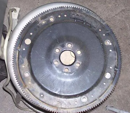

How about this, a 28oz, 160 tooth flexplate:
Thanks barnstang, I may have to do that, but what I really want to do is establish EXACTLY what is causing my vibration. I'm trying to avoid tearing down a newly rebuilt engine. I searched a couple of other forums and found one guy that said the number I provided showed it was from an early Fairlane. I seem to remember seeing a picture (on this forum I think) of a 50 oz and a 28 oz flywheel backside and the weight (visually) for the 28 oz was much smaller than what I see on my 160 tooth FW. I will buy another FW no problem , I just want to be sure the FW is the problem before I re-install the engine with a different FW. I don't want to do this again.
65Shelby Clone...thanks for the flexplate pic, but it really does not help because I want to compare a TRUE (known) 28 oz FW with my FW because I believe I have more than a 28 oz but less than a 50, if thats even possible.
