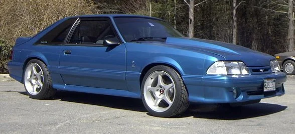

88stangmangt what does "y2k cobra's are nice to nice for my stang set-up though." mean? do the y2k's look good on foxes? do u have any pix of this?
He is too stupid to know what he was talking about.:lol: But I think he means, he wants the "mean" look. He tells me this all the time but he actually doesnt know what he wants. Dont let him fool ya, HAHA. And yes, the 2000 Cobra R wheels look great on a fox.
Took me forever to find a pic, so I hope you like it.:lol:
Dave
