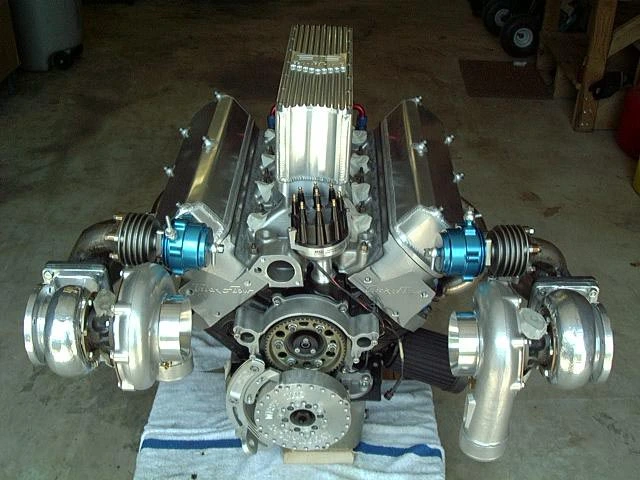

If not, customs turbo headers look cooler anywaise
Oh yes they do :D.
