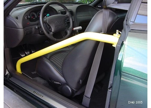

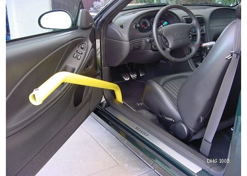

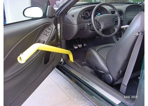

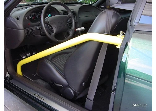

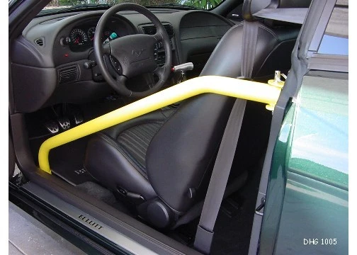

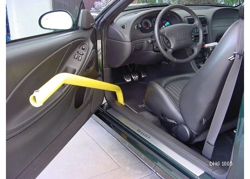

I'm not even gonna run really fast times. I plan to run low 12's but for the amount of times I will be going to the track soon I will be buying a cage just because its safer. With all the times I will be going to the track I will be increasing the chances of an accident and I value my life so I will spend the $500 for a 6 point w/the swing out side doors. Also you can mount the guages onto the roll cage. Plus they stiffen the suspension up a lot so it will help et's a little. Also if I ever get in a non track accident I'm still safer :)
Bornstanger said:
what are these swing out side doors u speak of? enlighten me.

now that i like and could put up with. now if only there were roll cages where you could remove the back bar so you could open up the back seat. then just chuck it in when you hit the track. then i would have absolutely no problem putting in a roll cage. :nice:
