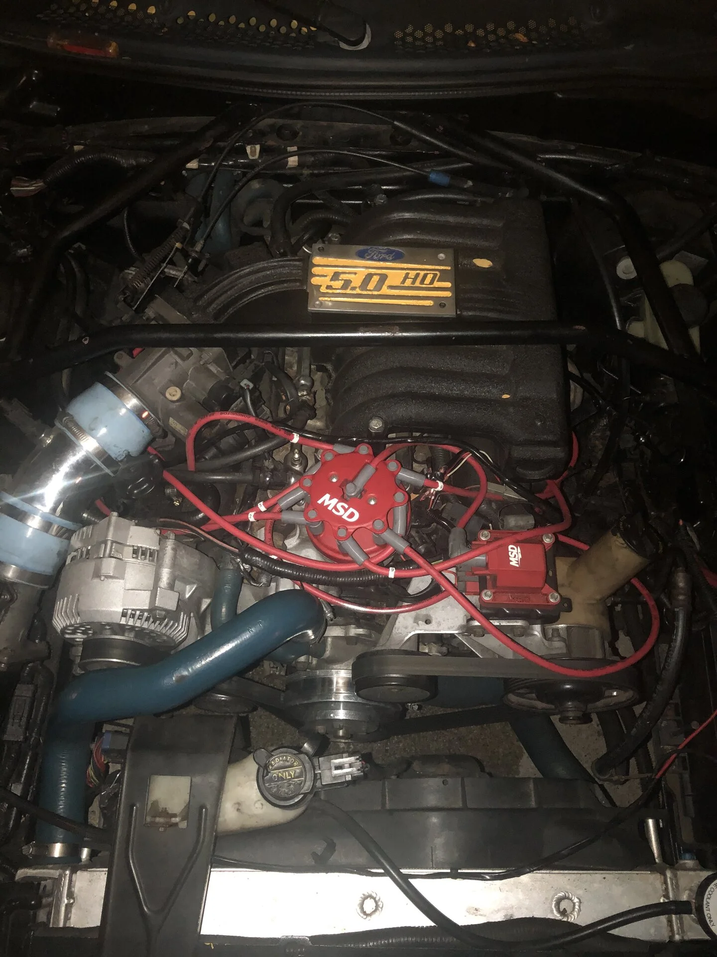

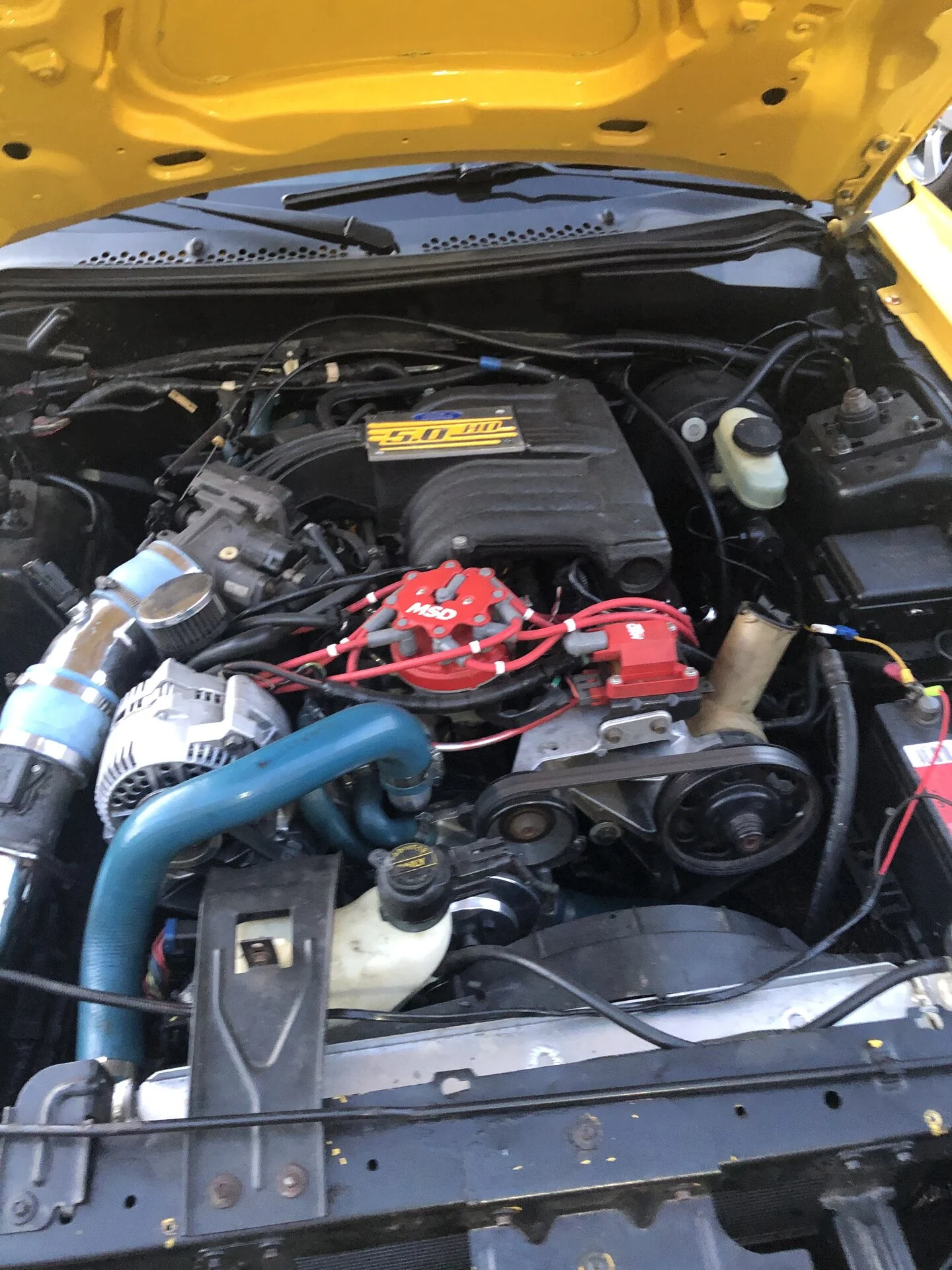

Hello All, thank you ahead of time. I have an interesting one here and it is surely beating me senseless.
1994 5.0 HO
Starting story, I bought the vehicle and it ran fine but turned over slowly (like 1 too many cranks as maybe not enough spark)
But it had the issue or what I think was an issue how the vehicle idled at 1200....and it made a small “pop”////miss around 1700-2400 RPMs.
Mind you, the vehicle has an entire MSD ignition set up, coil, distributor, 6A ignit box, an EGR delete, no cats, bbk headers, and a SCT-4 bank eliminator chip (where it surely runs better with the chip in).....I of course bought someone else’s issue.
I began messing with first changing the spark plug wires and spark plugs, dual tip denso. Vehicle ran okay but still was popping/missing on the rev decline....Car still bogged at certain moments.

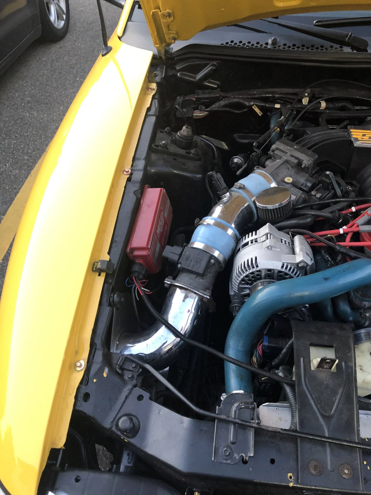

When unplugging the MAF the vehicle ran a ton better no pops or bangs and it was ripping around.....then all of the sudden it doesn’t want to run anything other than fouling out rich. Awful fuel smell. It almost seemed too coincidental to the fact the vehicle started acting up as soon as I messed with the timing slightly and new spark plugs and wires.
Interestingly, it also likes the old cap and rotor better, it does not like the new msd cap and rotor and the other one is all foul and Corroded But it likes it better 100%.
In the vehicles current state it’s symptoms are tough time starting, idling, very rich smell, LOUD backfires like gunshot ones...and it will NOT Rev over 2k.
It has 125psi All the way around Dry...If you have any questions or need more input but thank you everyone . Hopefully I Gave enough input.
More diag things to factor in.
fuel pressure from 35-45 psi. Has underdrive pulleys.

That being said, if you’re running better with the MAF unplugged, may likely be an issue with the MAF itself. What MAF is it running?
Can blast it with CRC MAF cleaner & see what occurs.
Car should run awful with the MAF plug removed.

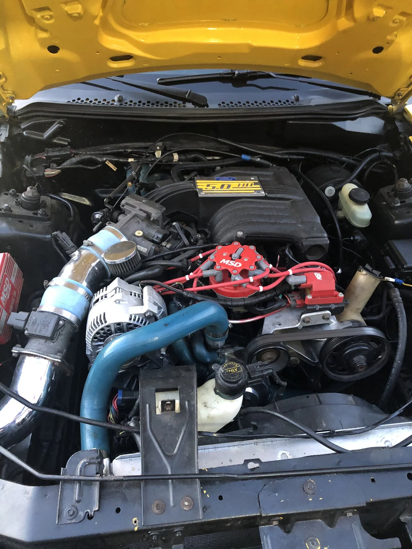

A few engine pics may help.

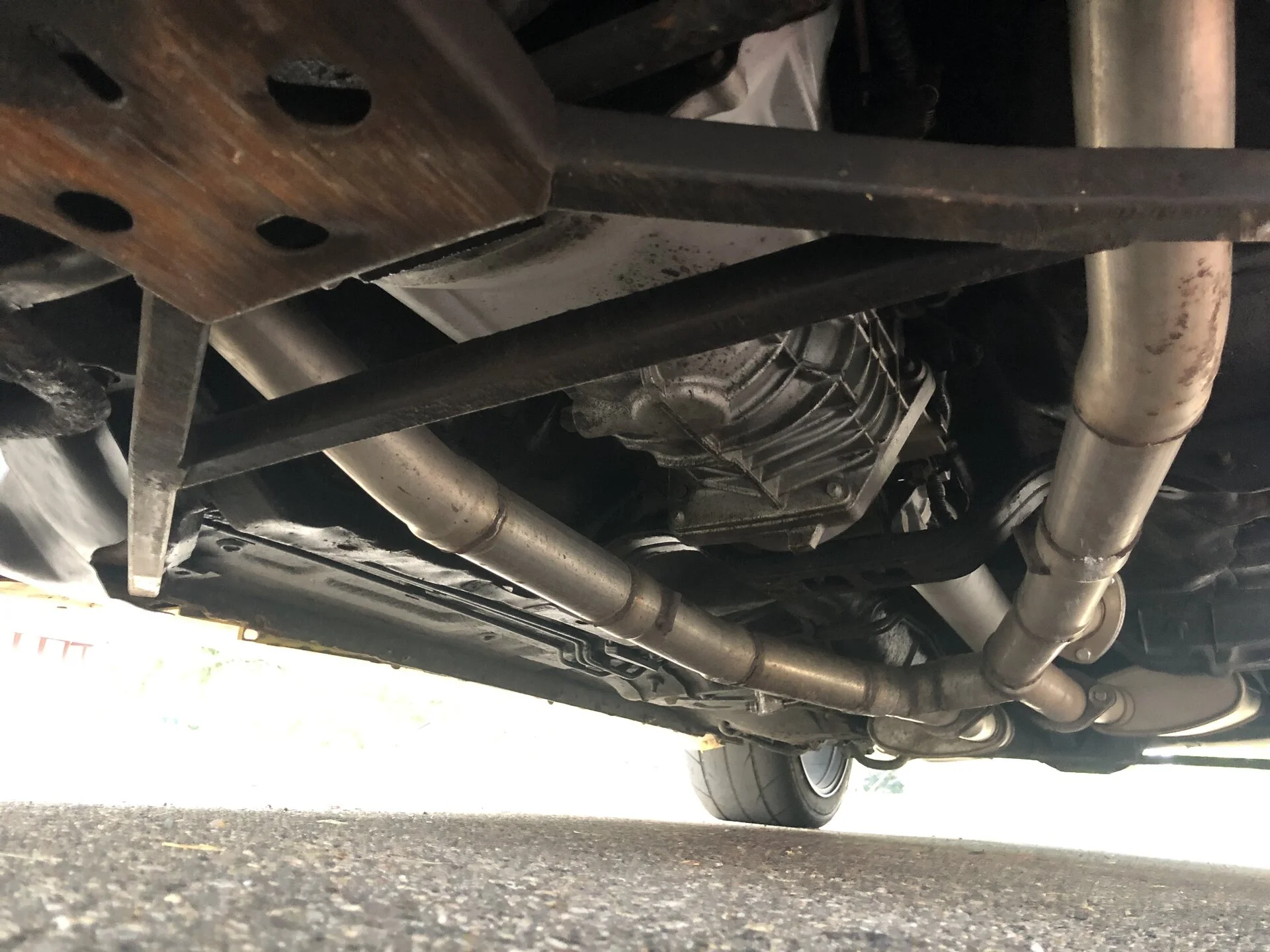

Running what Mfg H or X pipe, Catted?

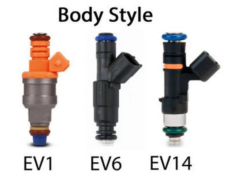

I also suspect the fuel injectors were "upgraded". Need to know what they are & the MAF they are paired with.
Your car looks like a Cobra which may have used different ECU, injectors, etc.

Everything I have definite and know is that the Vehicle has an EGR delete, under drive pulleys, 3.73 gears, ford racing radiator, a 180° thermostat.....I think....I did buy someone else’s project of course.
The SCT 4 Bank eliminator chip 100% does help the performance of the vehicle. Interestingly one time a buddy and I switched the wires on the cap to match a Cleveland setup and the normal 5.0 firing order, the vehicle ran SMOOTH but had absolutely NO pick up, it revved up slower than a turtle. It seemed as if I was in 5th gear going 20mph and then stomping on it, took a while to gain power.
The denso dual tips are probably garbage, did I mention interestingly the vehicle likes the older and beat up cap and rotor. Or so it seems.
The vehicle has 125 psi on all cylinders when the motor is dry/cold.....so sitting for multiple hours. Dry as in I didn’t put oil in to see if the rings are bad.
I would say over my entire duration of owning the vehicle is has never run 100%....maybe 96% but those small hiccups where I could hear it skip over a beat/miss at around 1600-2400 area were weird and the 1200 RPM idle (possibly caused from the tune).

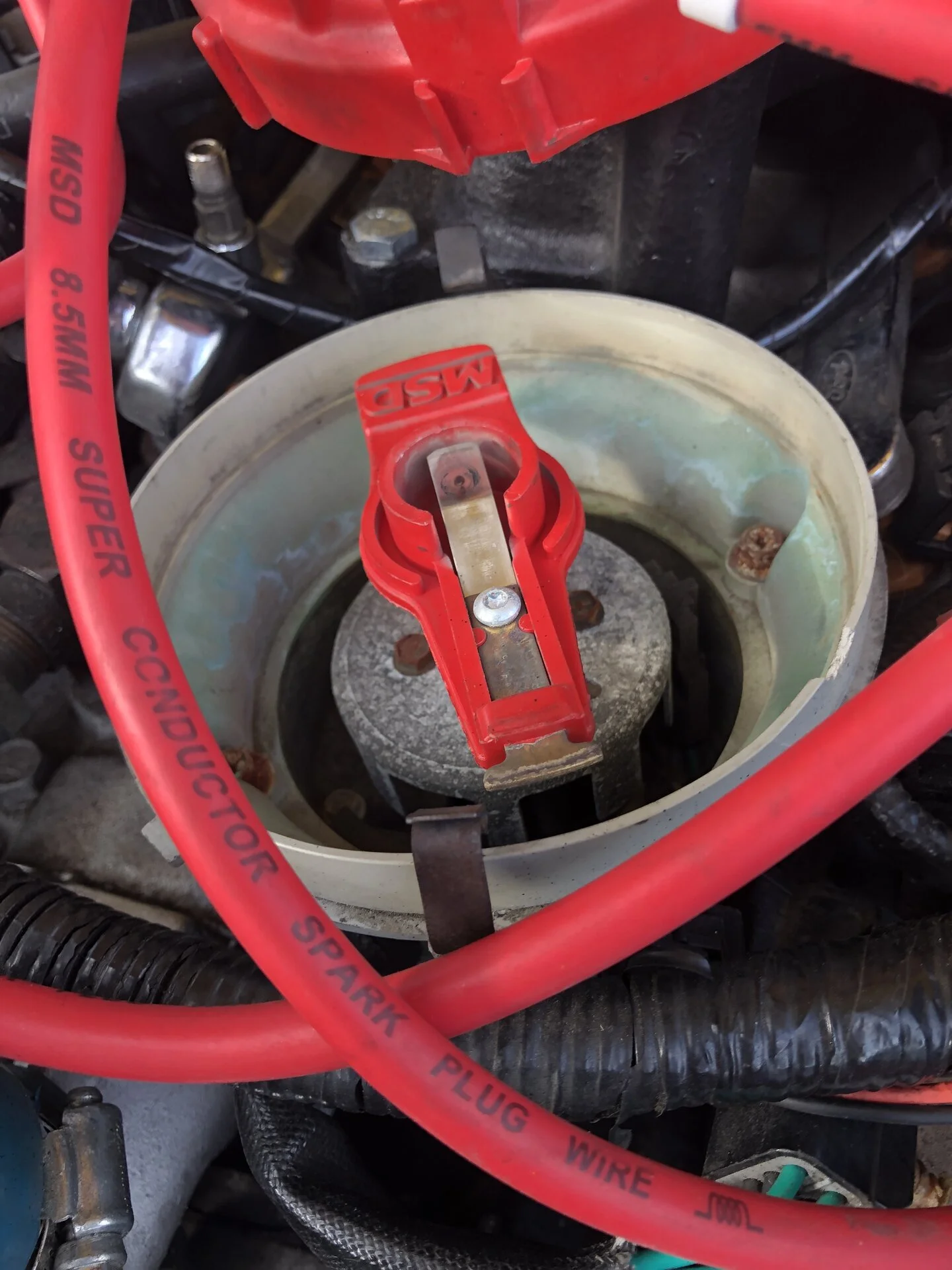

Take a picture of the distributor when the engine is at TDC according to the balancer & pointer.

Pull the #1 spark plug, hell pull them all, you need to change them anyway and it makes it easier to turn the engine by hand. Find 0* on the balancer and mark it, while you are there mark 10* , 12* and 14* btdc too, hold your thumb over the #1 plug hole and crank the engine till you feel air push out, this is the piston coming up on tdc, stick a thin screw driver in the plug hole, crank the engine by hand feeling for the piston to move the screw driver, you can use the piston moving the screw driver to feel the piston move up than down, as it stops moving up that is tdc, your balancer should be at 0* and the rotor should point to the #1 spark plug wire tower on the distributor, oh, forgot to mention you need to mark the outside of the distributor where the #1 plug wire is.
While you are fooling around finding tdc/ rotor pointing to #1 plug wire, move the balancer back and forth noting how far you have to turn the balancer to make the rotor move, this can tell you how worn the timing chain is, although timing chain wear is less of an issue now than in the past.
Remove cap to see rotor position.
