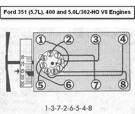

You should be using the HO firing order. What firing order does it run

An earlier post stated you changed it to the Cleveland firing order (which is the same as the 5.0 HO firing order, which you car should use) and it ran smoother. What firing order is it currently using that’s causing the issues?
