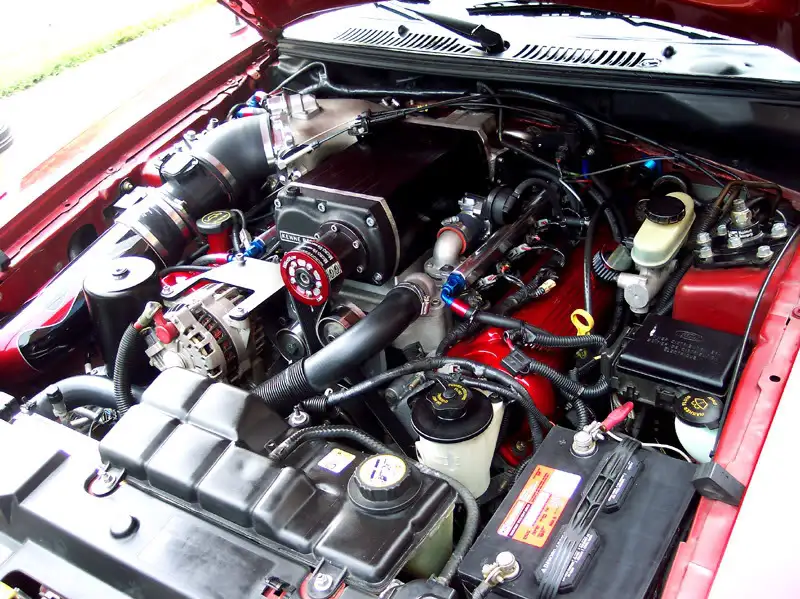

I don't think mine look too bad.
I do think stock 2Vs have the ugliest engine bay of any late model cars and it takes some work to get it looking good. I like how the larger 4V valve covers looks cleaner and more menacing. And stock Machs and 03 Cobras look great from the get go.
