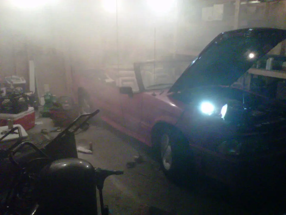

Anyway I have white smoke billowing out my tail pipes.. Which I know is coolant..
I just changed my tbi Gasket.. I was a little confused about the way it went on..
I don't believe it's my head Gasket as I just changed them.
Can anyone give me some insight on this?

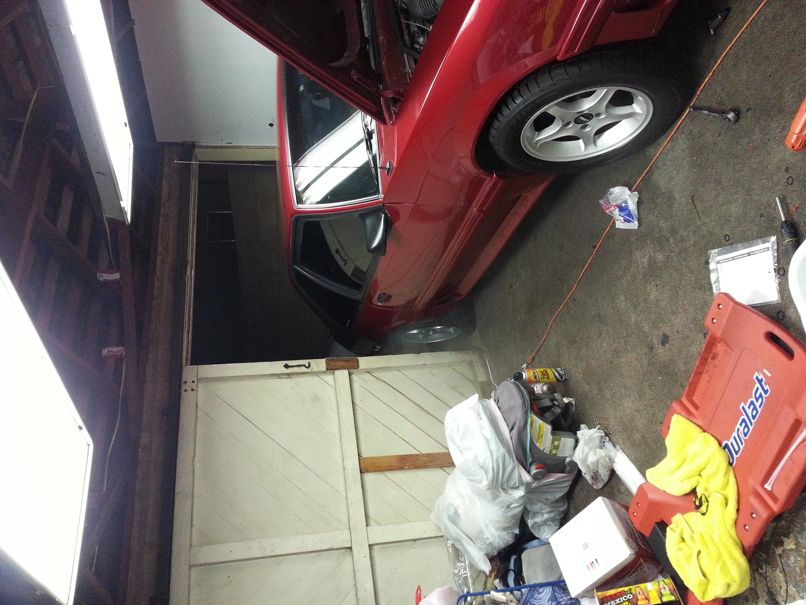

Alright soo it was the tb as we all expected!
I just capped the coolant lines for the test and, after I put the correct Gasket on and smoking for 15min it stopped!! What a relief it wasn't the head Gasket... However I think I'm gonna pull the stocker and do a gt40!
