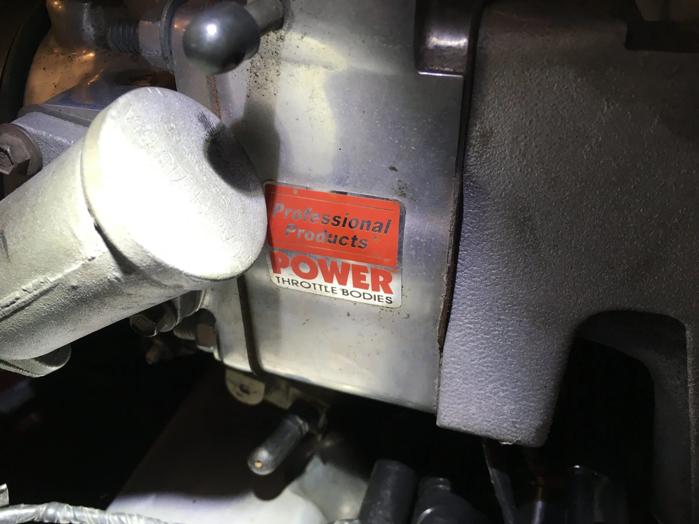

Anyone know what brand this TB is? Spacer says Professional Products but I’m not sure about the TB.
Most importantly, how to I quiet the whistle at idle? It’s pretty loud.

Likely a bbk, mine whistles, I don't remember anyone complaining about any other brand,

Looks just like the pp TB I have on my work bench. It whistles as well

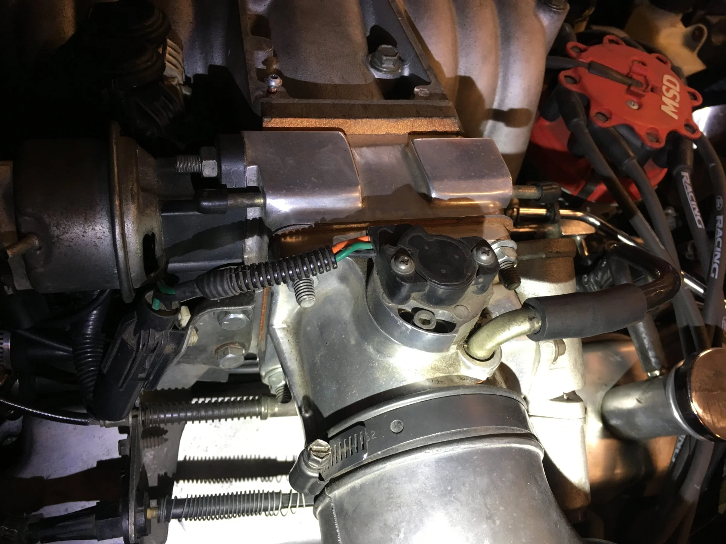

The one I have whistled when I first put it on. I was researching what might cause it and found an article that talked about the air passing over sharp edges in the TB could cause it. Took a dremel with a sanding tip to the ports going into the IAC and rounded and smoothed them out and no more whistle.

that's 100% professional products spacer and throttle body, they're the only company that has that round adjustment ring for the TPS built into the top of the throttle body that i know of. i have a 90mm PP and it whistles when de-accelerating around 1400RPMs. i originally thought it was my Trick Flow manifold whistling and it may still be, but since i went supercharged, the whistle no longer bothers me that much

Take a dremel. Remove iac out. Round out the edges on the two holes passages on the throttle body for iac.get them little bigger that should fix it. Did it for me on a 65mm bbk
