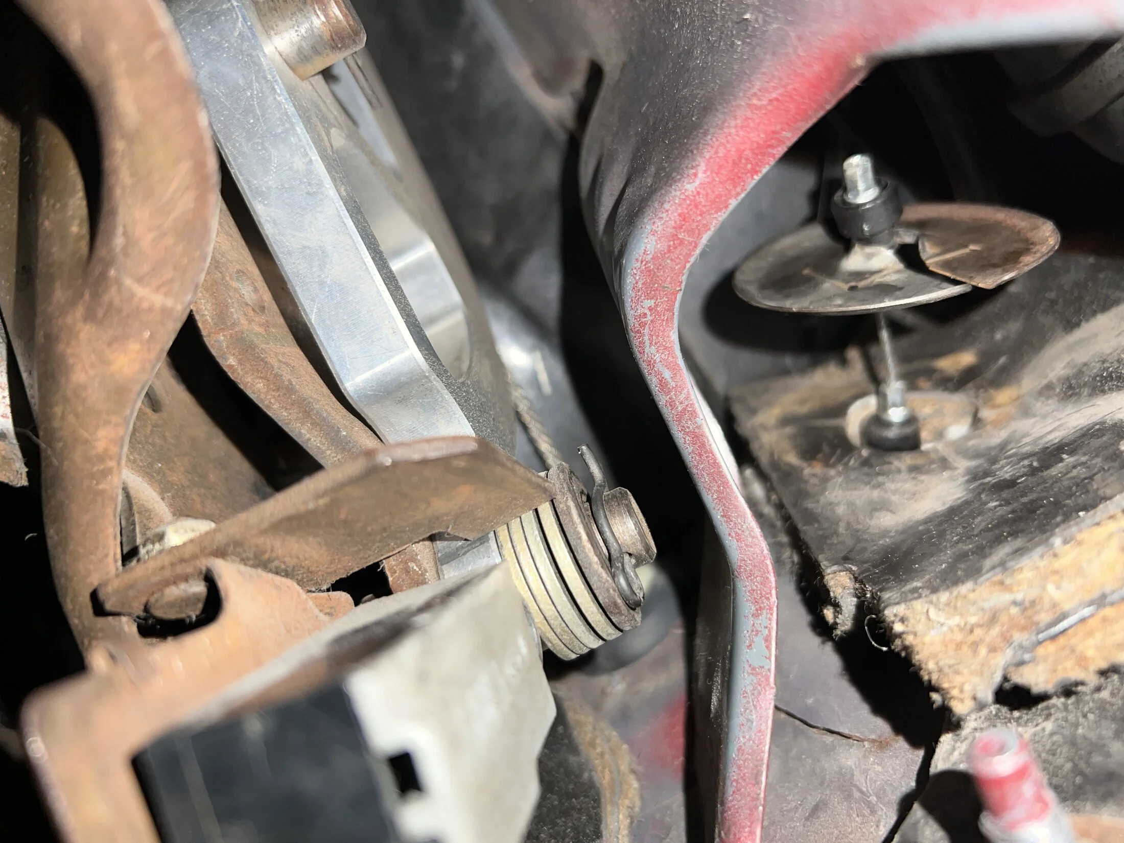

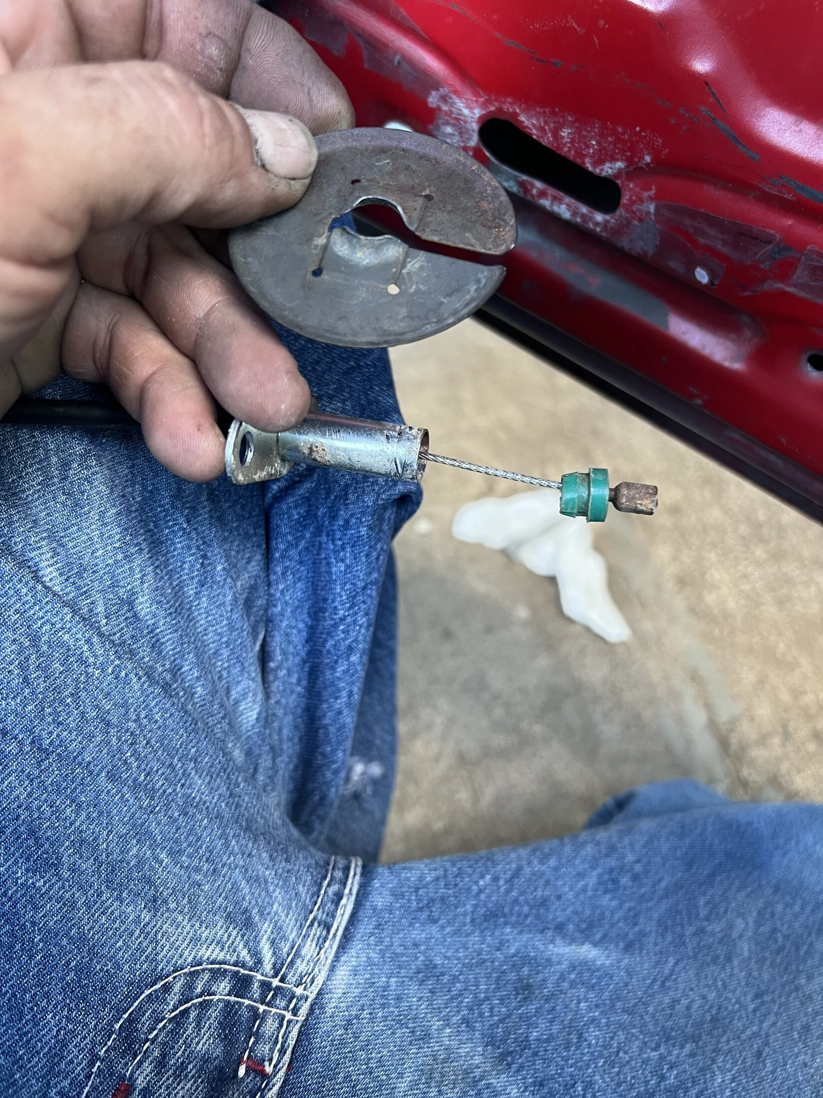

I have a question I bought a throttle cable
/accelerator cable and it’s not right I see a small washer but it’s has a piece of juke backing between i believe it goes over or cable slides Thou,is it ok to cut that juke backing to get it to slide over cable?

I’m not understanding what you want to cut off. He green piece snaps into the front side of the gas pedal and the round washer with the slot in it secures the cable to the firewall.
Reactions: Creomod
Looks like you could slide the washer under the jute and secure the cable without cutting anything. Metal to metal contact ( washer and firewall ) may cause noise.
