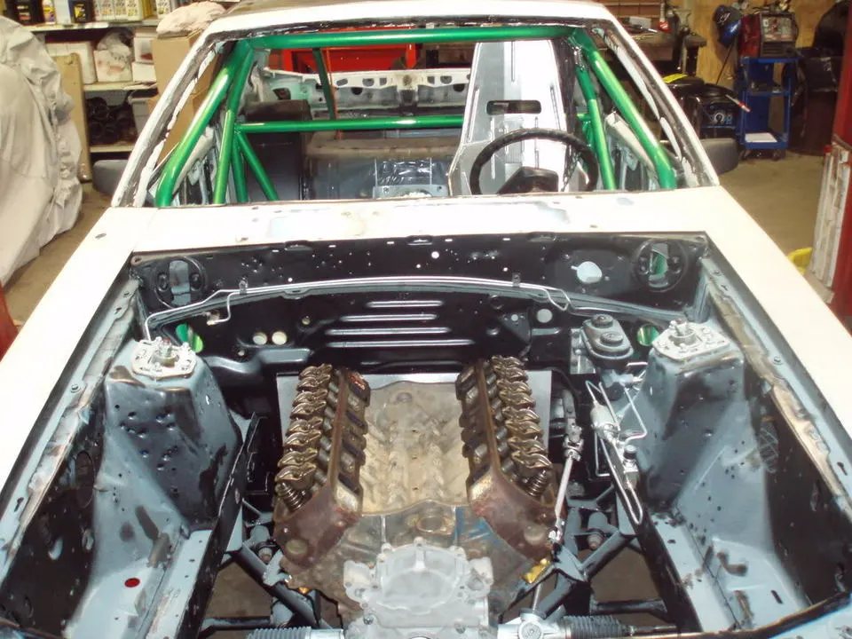

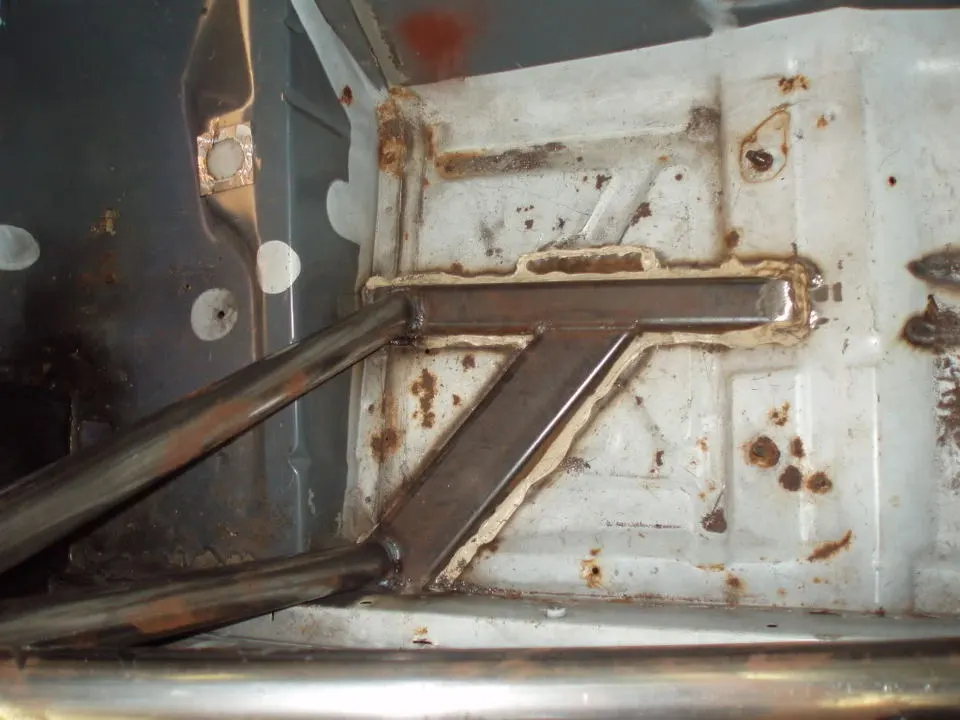

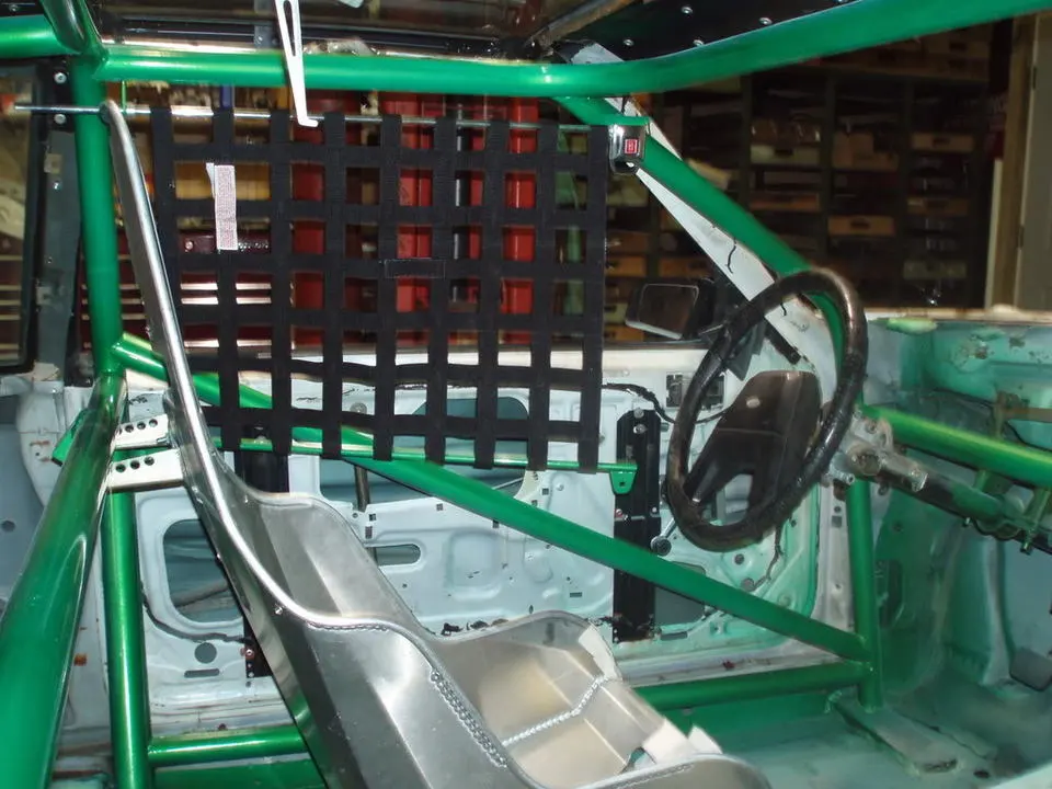

This project is my latest mess. I'm about a year into the build and just figured I would show everyone what I've done so far. I've done all of the fabrication work myself and a friend stretched my quarter panels and painted my roll cage. What does everyone think? The car will be driven on the street and I will compete in NMRA True Street. If everything goes according to plan the car should go Mid/High 8's easily.

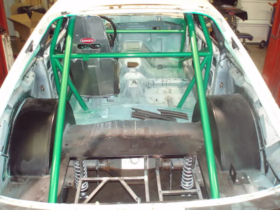

Fuel Cell and Battery Mounting locations:

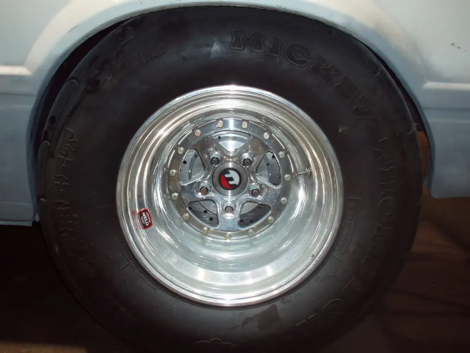

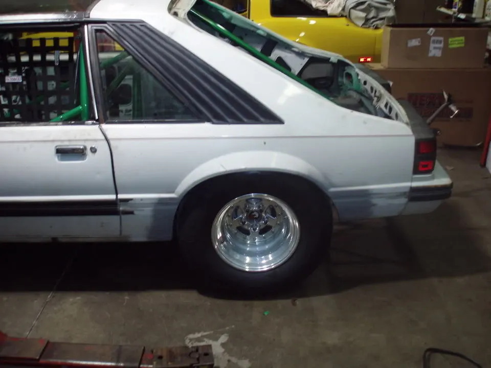

Stretched Quarters and 315/60/15 Drag Radials

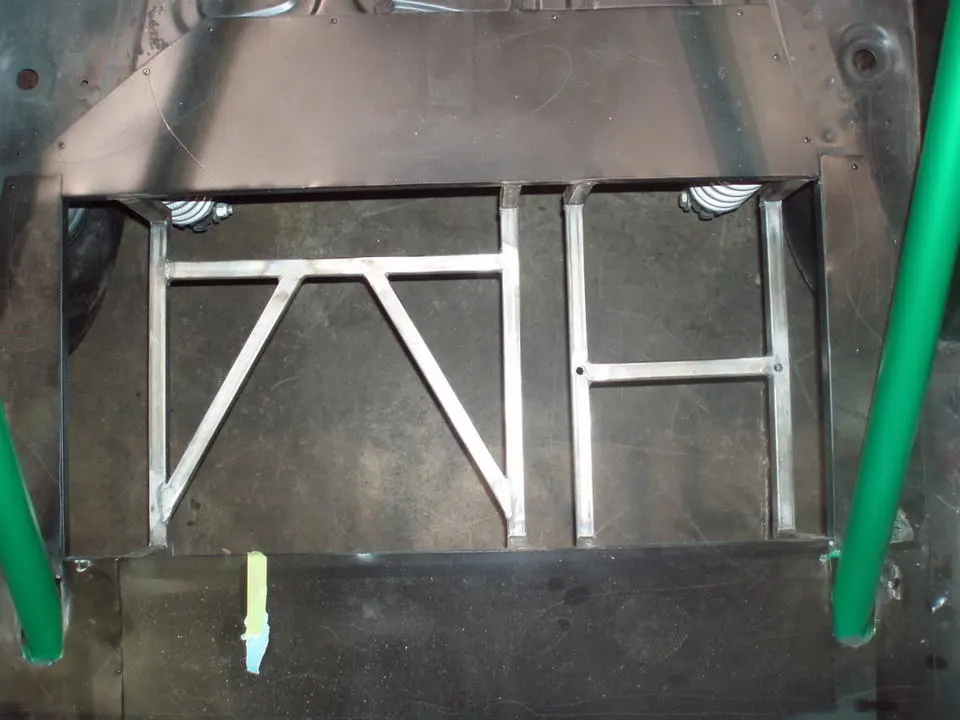

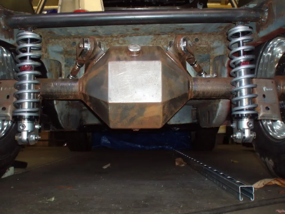

Moser Fab 9 rear and Coil overs

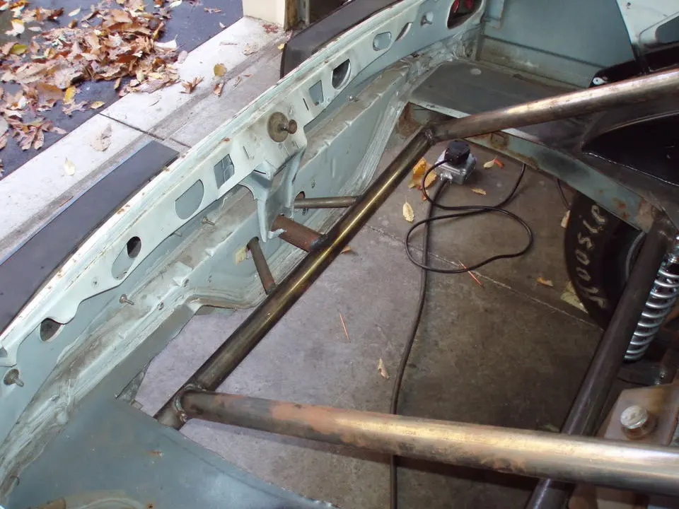

Parachute Mount:
Through the floor sub frame connectors:

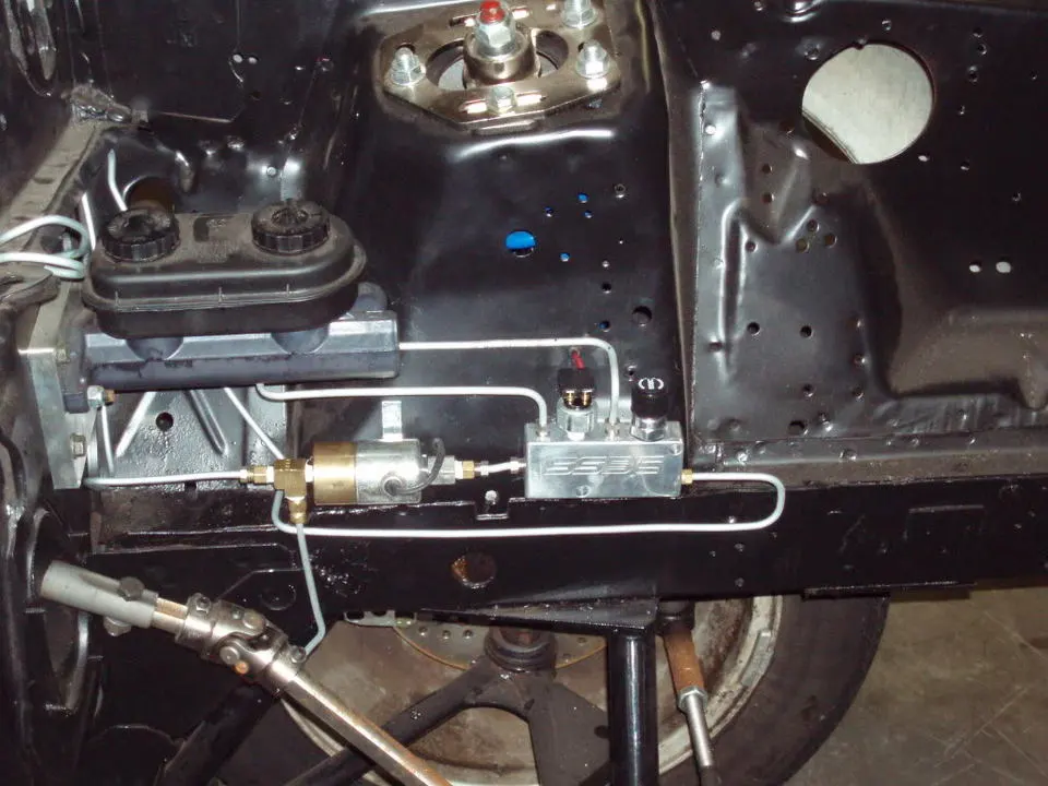

Manual Brake and Proportioning valve:

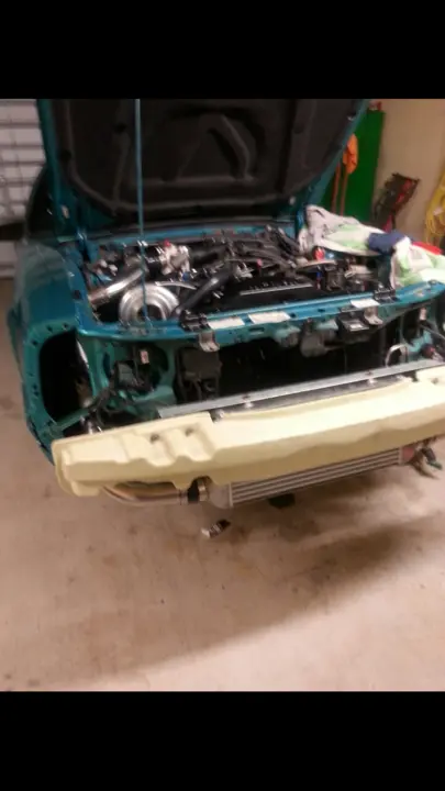

Test fitting block and trans:
I'll be mounting the air to water intercooler and piping in the next few weeks so check back for an update.

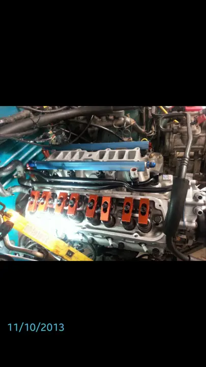

I wish someone had a parts list i would piece together a fuel system i am just intimidated by it because i have never done it .
Well, I bought my stuff here and there. All used except the pump. My rails and crossover hose are old school cartech as is my FPR. I bought lucas 75lb injectors from a member off this forum who is no longer around.. misc -AN fittings from jegs, stock main lines and a stealth 340lph in tank pump. My tuner says that'll support 450-500 rwhp all day long, and If I step ia little I need to run 1/2 lines from the tank to the front. As far as making lines, I just buy braided SS hose from Jegs or Summit, along with hose ends in whatever -AN size I need, and build the hose. It's really straight forward. If you have questions pm me..
I really just need to sit and draw it out on paper so I have a parts list to get it all done
