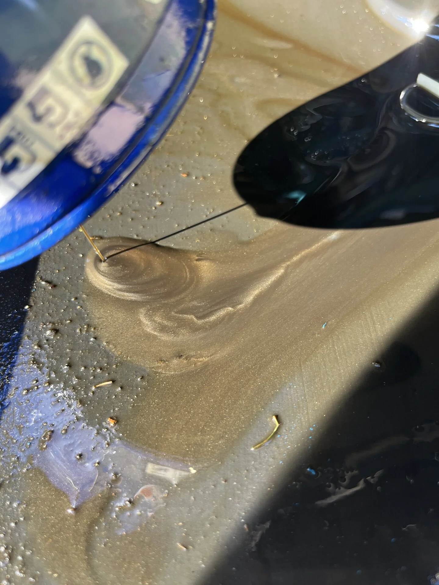

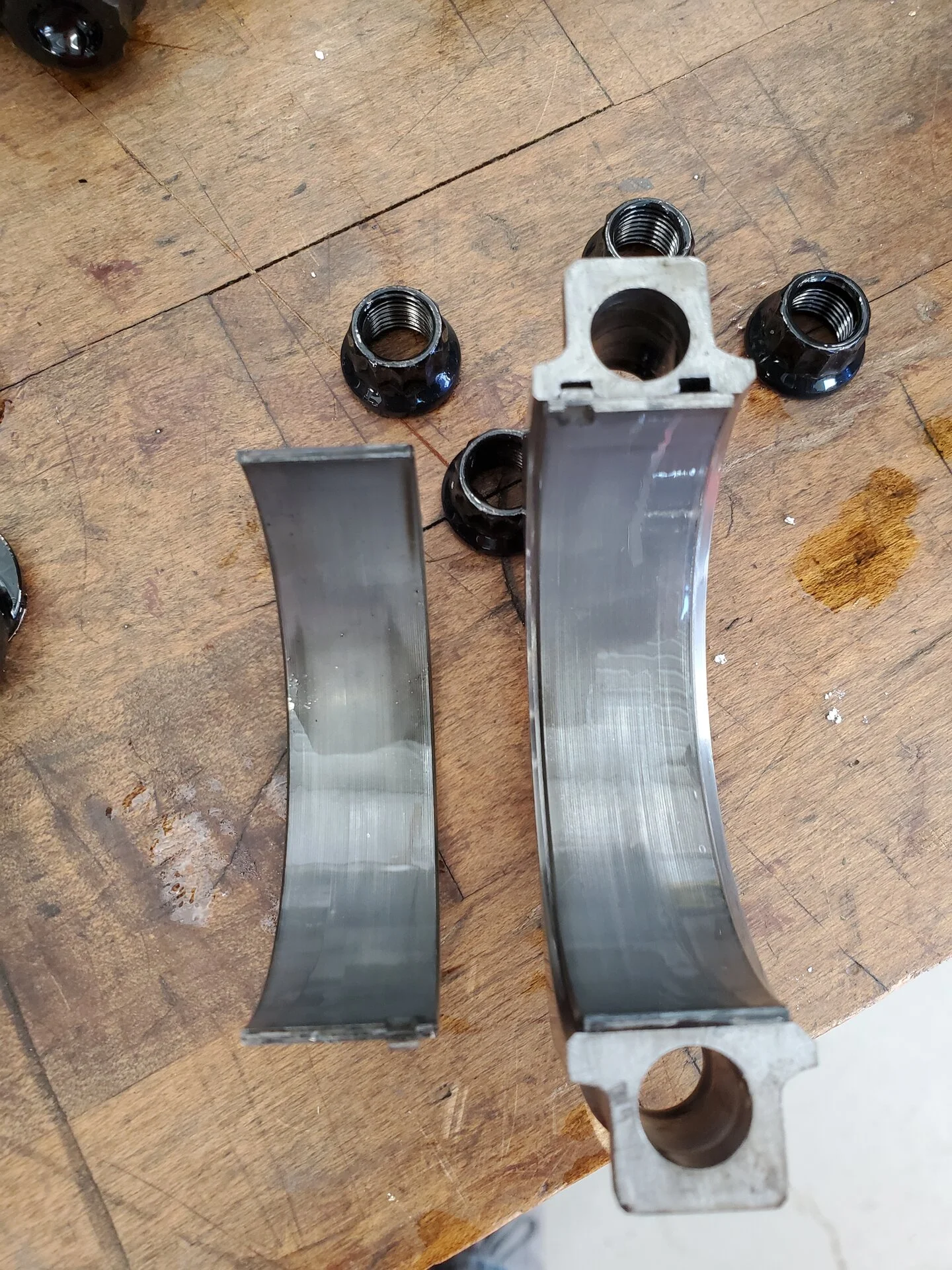

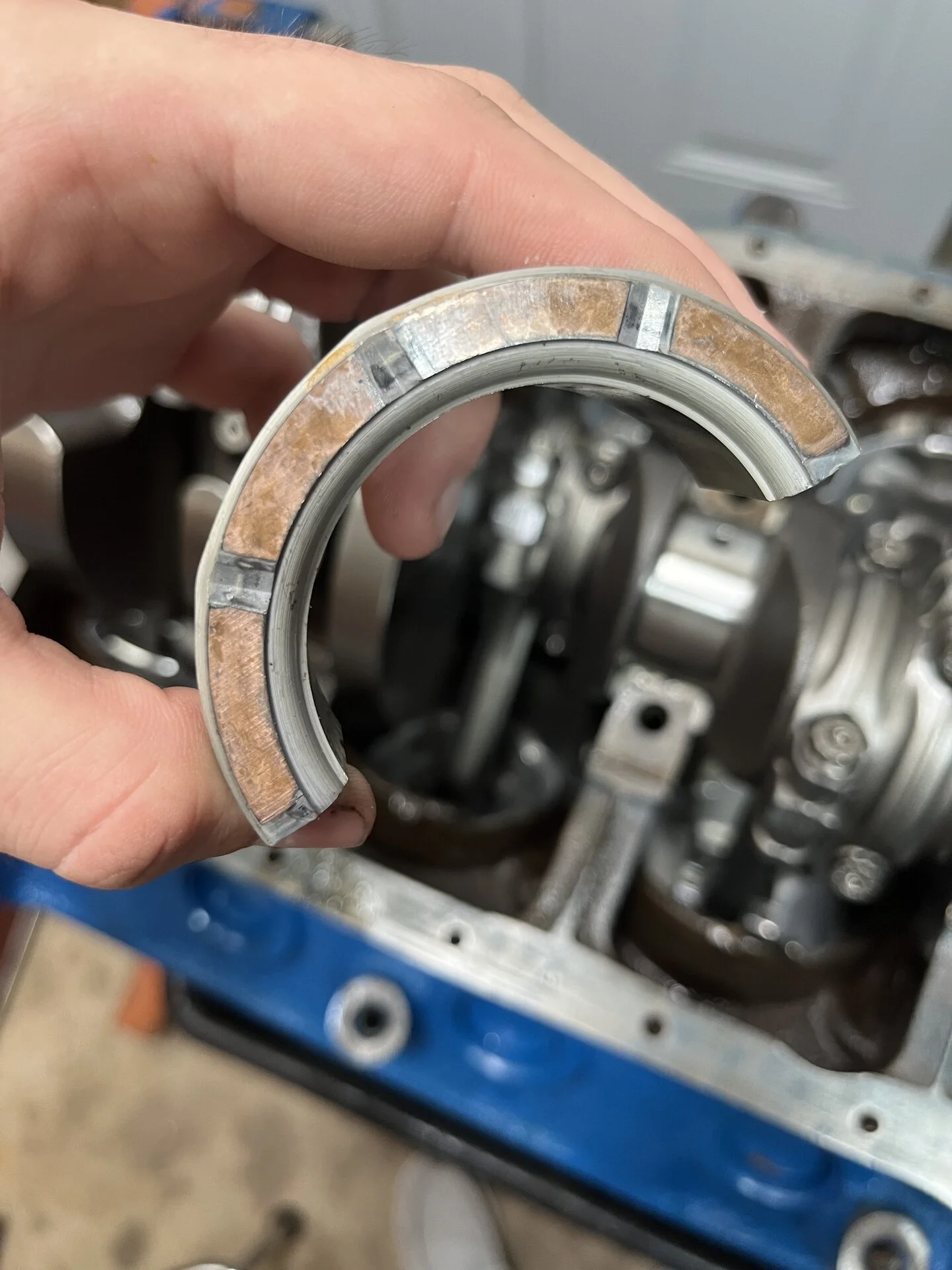

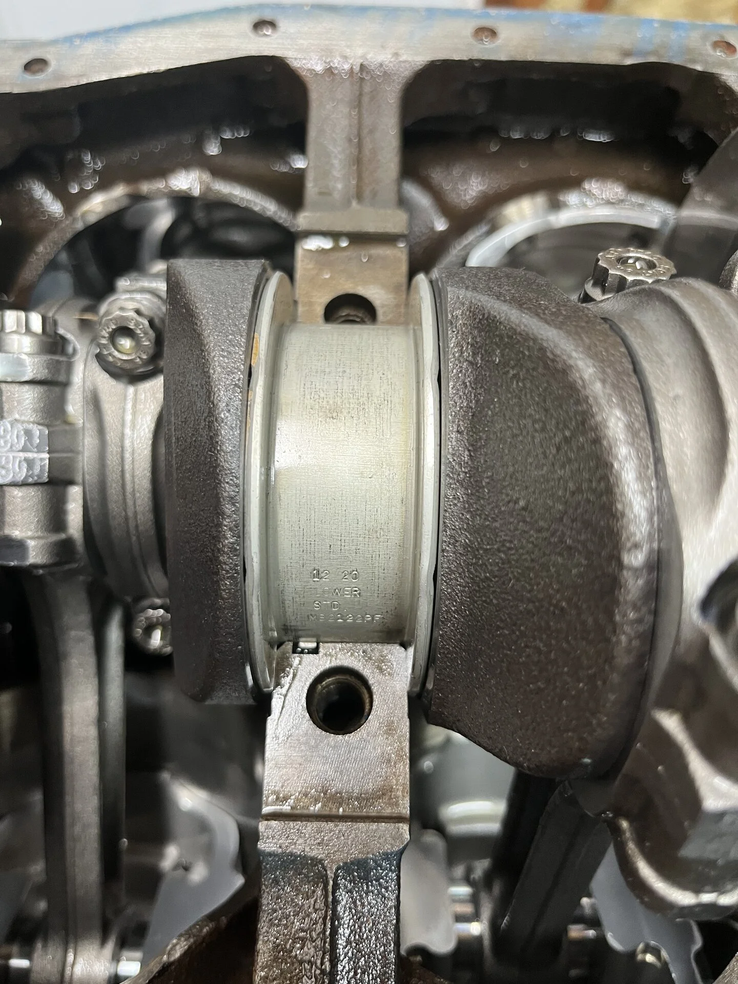

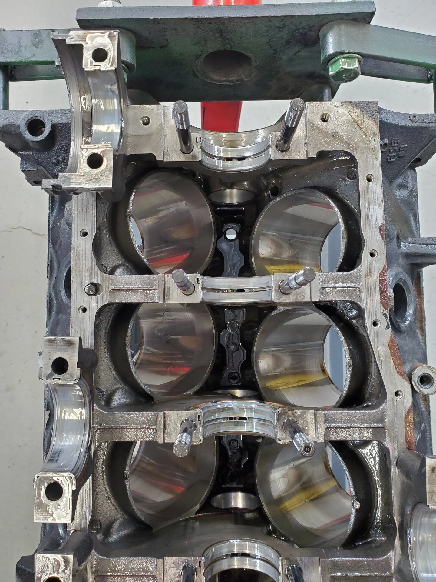

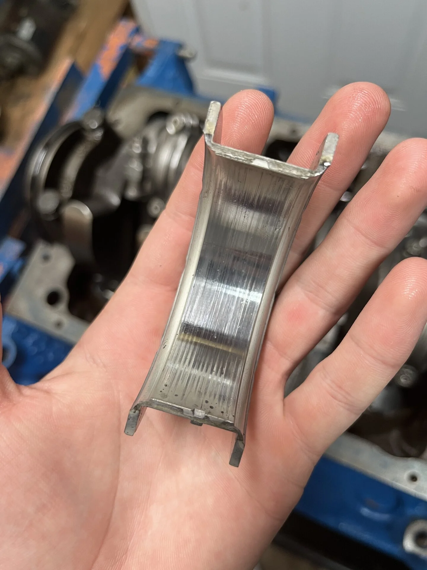

I tore my engine apart after finding gold fine metal in my oil. Engine has about 200 miles max. Does this look normal?

Nope not normal. You can see alot of debris ran through this bearing. Those dots near the bearing tang are evidence of debris embedded in the bearing either it was put together dirty or you have other issues. The thrust looks almost new or factory machining marks? Or is that wear too? Can't tell.

Well this bearing has less than 200 miles on it, I just put this motor together like 6 months ago and the oil looked like that.
Check the end play if you haven't all ready. Its definitely open end up some clearances on the thrust. you will see some wear from break in but that looks excessive like a drive train issue to me, . Reinstall and check the end play numbers.
After a second look it looks as your thrust is misaligned. Only one half is showing wear. Some times the cap will need to be seated to allow proper alignment for both bearings as red notch stated a dial indicator showing end play may point you in a direction.

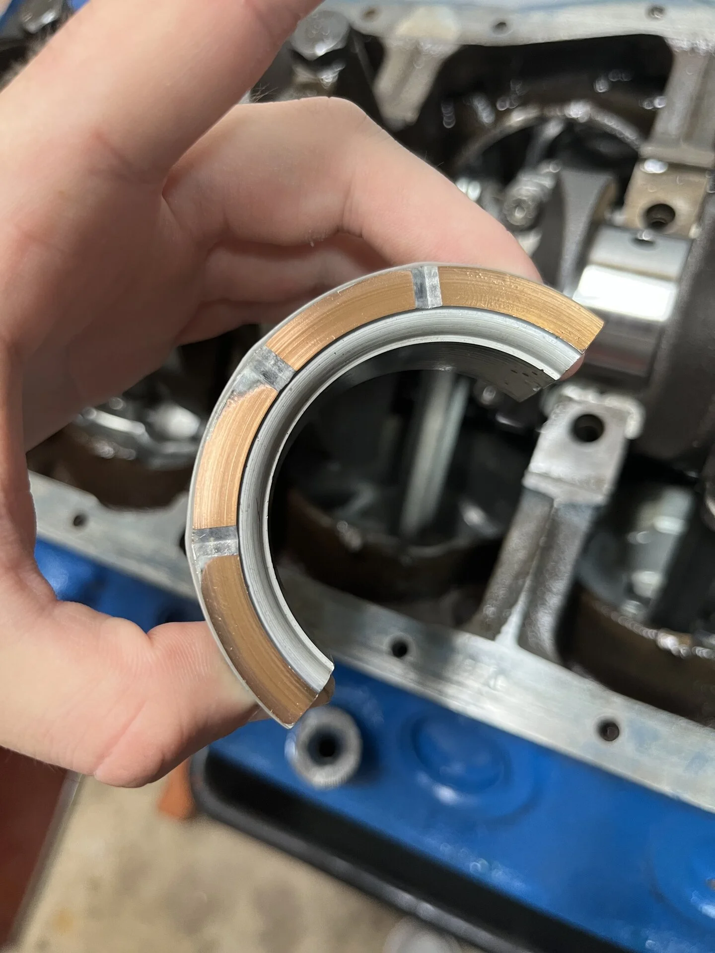

Here is a example of decent bearings this is from my 331 that I put together back in 2009 that I tore down for the first time this spring, it regularly saw 8K rpm. Remember your crank and bearings never touch it rides on a thin oil film.
