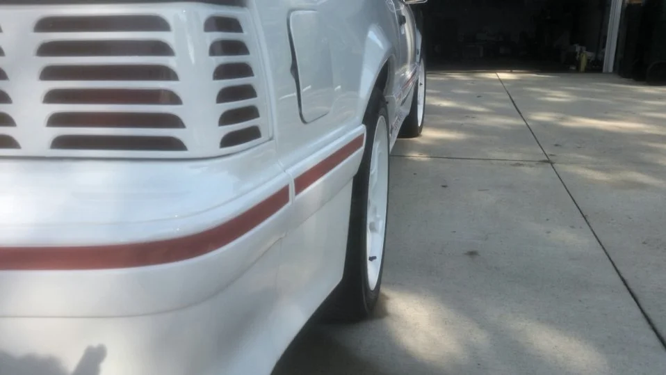

I am looking to do a disc brake conversion but keep 4 lug because I like my wheels. I've been researching at it seems the thunderbird tc rear axle is the water to go. I am currently running 255/40/17 tires. Has anyone done the swap with this tire size? Will it look funny with how much they stick out with the extra length on this axle?
If it will look ridiculous, are there any other options with the tc rear end?
I attached a pic of how my current tire looks with the stock axle

Stock wheels and tires clear OK, larger tires may require the inner fender lip to the rolled.
Seriously large tires may need wheels that have different backspacing/offset, otherwise they will rub against the inner fender lip even with it rolled.
And yes, I have been there and done that! With success! :nice:

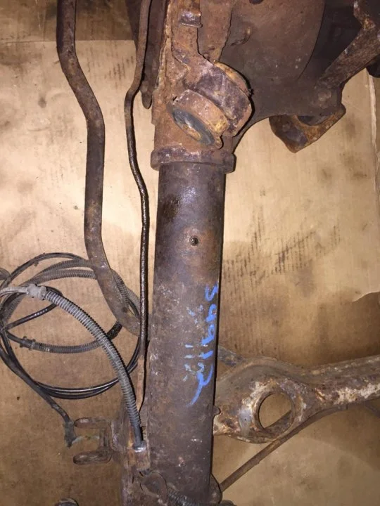

Quick question, I was looking over the axle this evening with my buddy and we noticed a hole in the axle. I am not familiar with any axle and this will be the first one I am messing with. Is that hole supposed to be there?
Yes I believe that's normal. I have them on mine too on the passenger side but there is something missing that is supposed to cover the hole. I do not know what the hole is for, maybe some sort of vent.

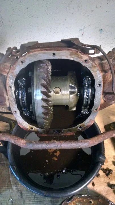

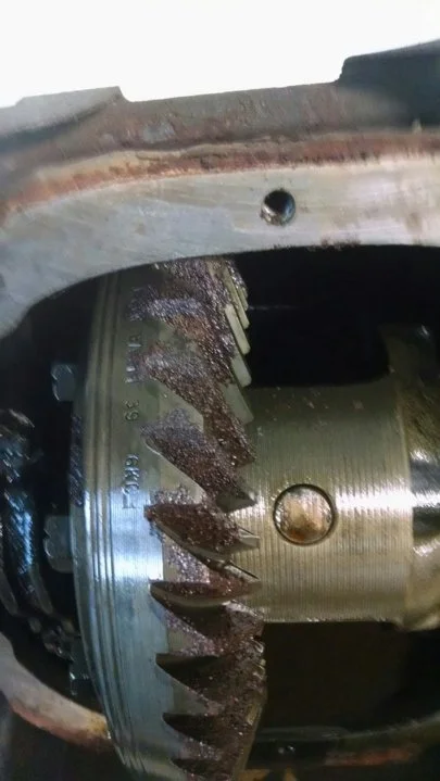

So, I pulled the cover off to see what the gears look like and it looks like there is rust on the gears, see pics. Is this shot? Should I return it?
That's nasty looking! Surface rust will usually wear off during the first 50-100 miles followed by an oil change, but that looks like more that slight surface rust from the pictures.
I think that I would either find another T-Coupe axle, or plan to replace the gears and bearings in that one. Replacing the gears and bearings isn't something that I would recommend unless you have a person who has solid experience doing the job to work alongside you and help.
