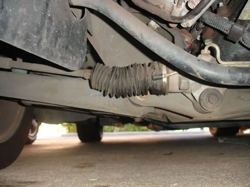

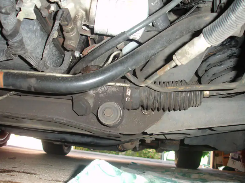

How do I fix this extreme angle of my tie rods? I know that since I lowered my car (c springs, no isolators), it's going to be at an angle, but I had no idea it was that bad.
when I get new boots, I'm popping the isolators back in, and maybe adjustable tie rod ends?

the outer tie rod end boots are the ones on the spindle ( near the wheels) the inner tie rod boot is the big flexible boots on the steering rack..
it's probally the outer tie rod boots you are talking about.. if yso you need outer tie rods..
and to fix the extreme inner tie rod angle you can get one of those adjustable tie rod kits. a few different companies sell them,.
