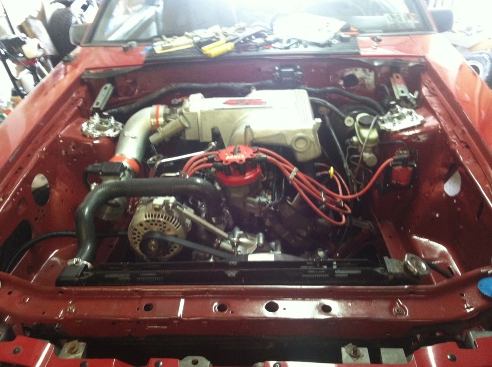

Thanks nik
All buttoned up

Jul 9, 2012
#127
  • Jul 9, 2012
  • #127
Looks good D, just remember to put a stock airbox on that C&L...if you put a cone filter on the end it will lean it out 1 full injector size...
