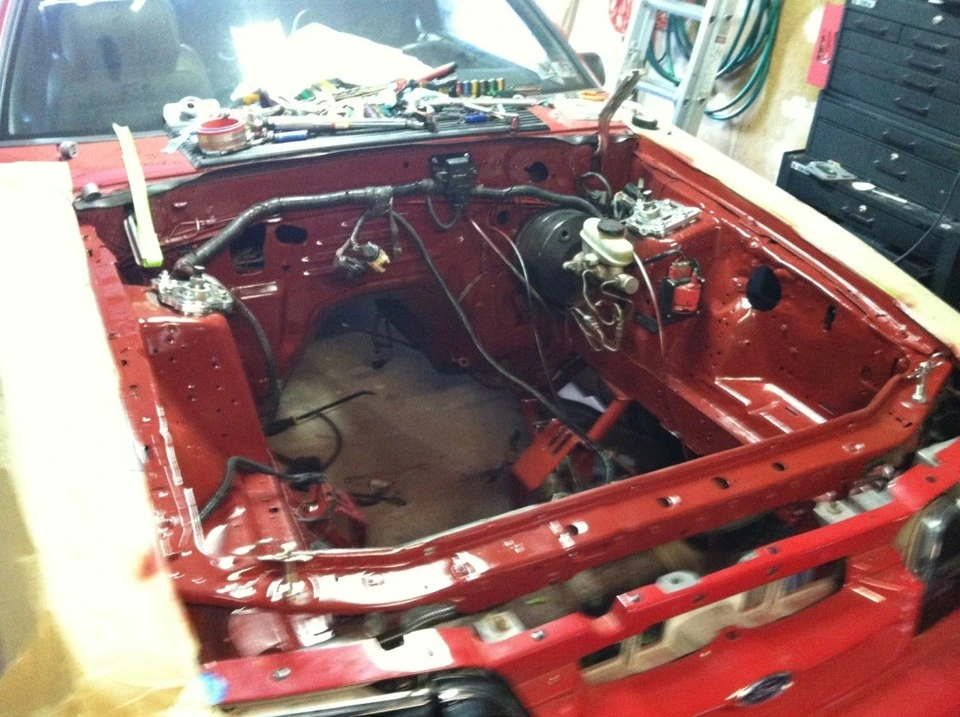

Wires be gone!
Got a few more things to clean up and I gave to cut apart the o2 harness to get rid if the starter wire low oil wire and maybe rewrap it. Cleaned the bell housing up and boy that was dirty!

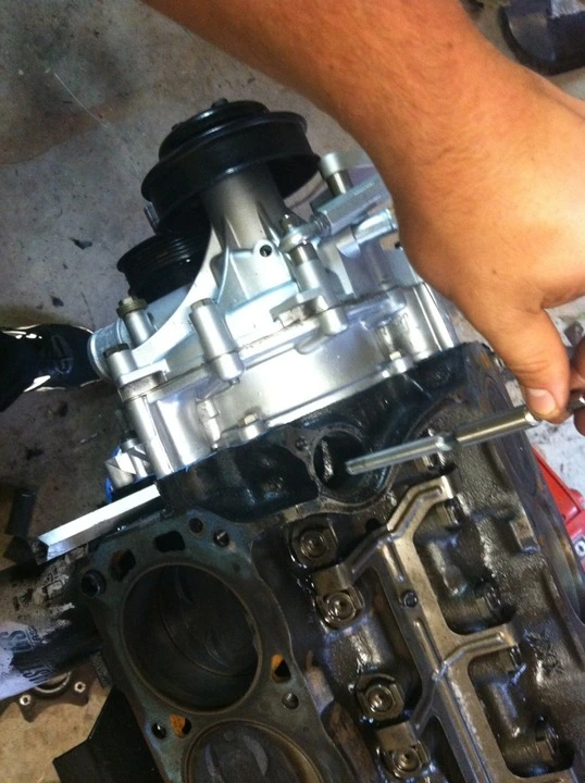

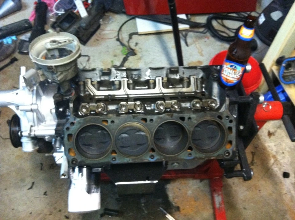

milling them valve job and springs... i'll be taking the EGR bump out of them and maybe cleaning up the casting on the intake side. they are the GT40M heads which have the bump but no EGR. im hoping we dont go to far since the M heads have 67CC chambers not sure if the chamber is higher or just a different shape. the end result will be needing to take rick the short block to have the pistons cut also
went over all the bolts to double check they were torqued right. everything is ready for the heads from rick now...

talked to rick yesterday... hes going to have the heads done by the end of the month... which is cool with me since i knew he had a back log of stuff to do since everyone always waits till the last minute for hot rod weekend...
he's going to do a few other things with the heads like some porting and polishing and removing the EGR bump
