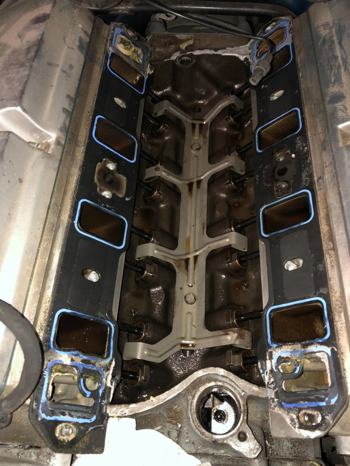

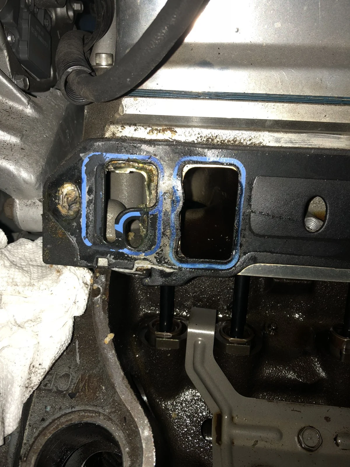

Considering I have the intake off should I dig deeper? I really don’t want to remove the heads unless I have to but I know that can tell me more. Prob is at that point I’m almost redoing everything. Below is a pic of the intake gasket and a car shot. It was the color that pomade me pull the trigger.....

First thing I noticed in your picture ,is that the intake manifold gasket at water jacket opening, there is a tab that is to be cut off , so that tells me the previous owner did not read the directions on how to install gaskets. tfs heads have a number stamped on the outside face as to what size heads they are .

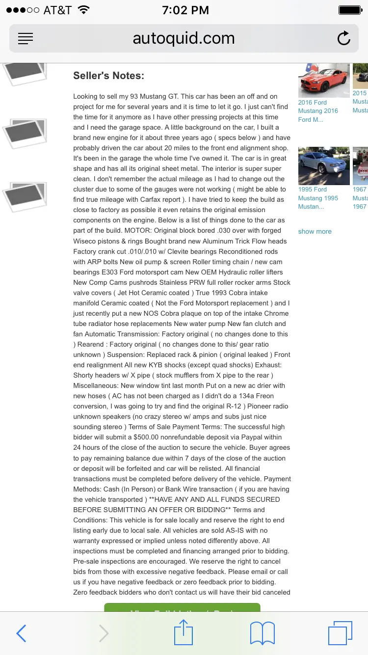

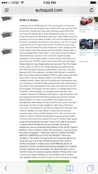

Yeah my confidence on how this engine was done is not high. I’m hoping the heads are done right. I did find some info from the listing when I bought the car. See attached pic with details.
My goal here is not to redo the whole car but to get it streetable. I actually have another 93 that is going to be my true project and I really just wanted this car for cruises around on a nice day until the other car is done. Of course I may have 2 projects now.....
