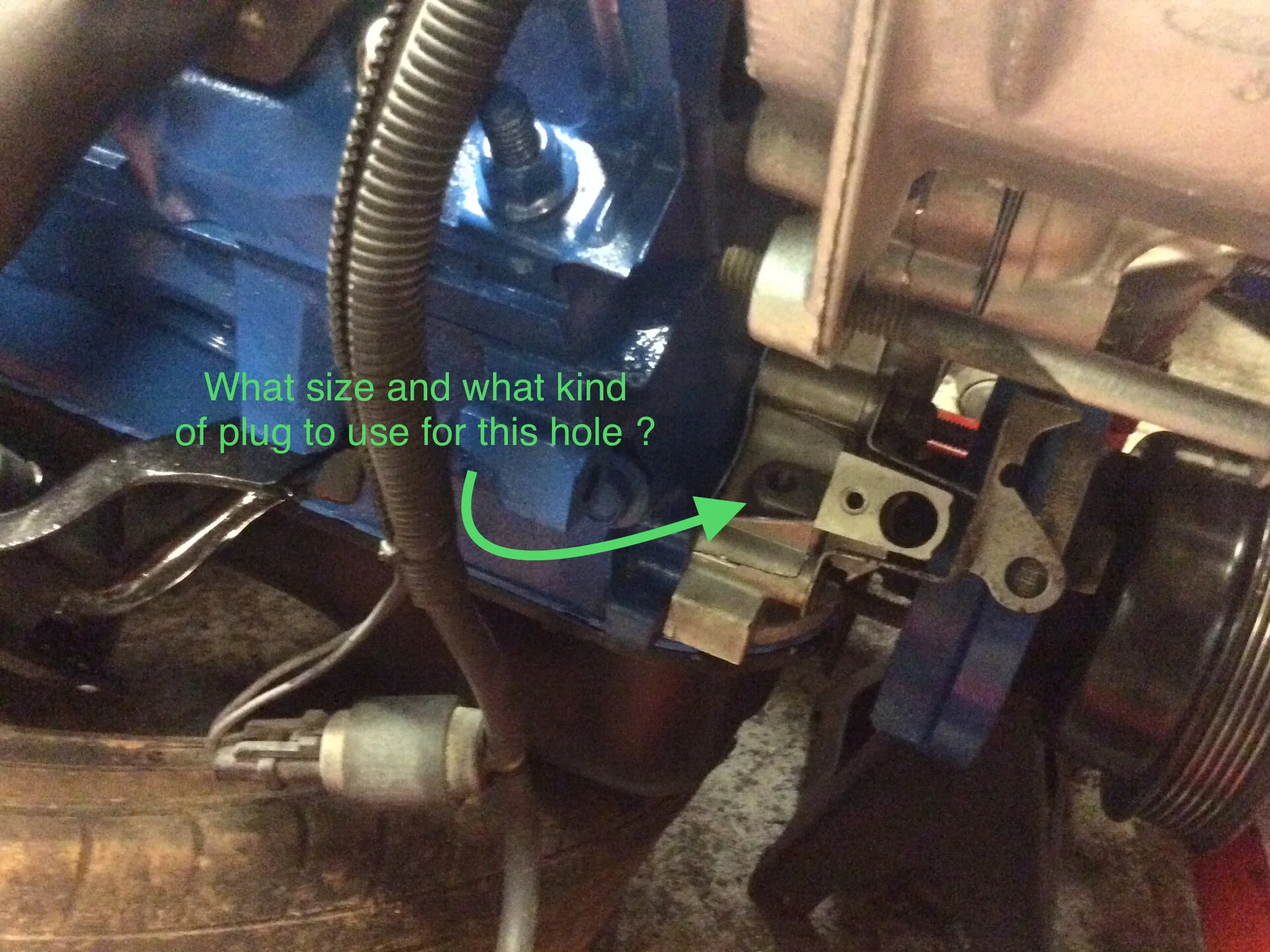

I think there also is a tap in plug that fits it too.
That is correct, there is a press in plug for that hole. If you bought the cover new, and the package was unopened, it would have been in the packaging.
