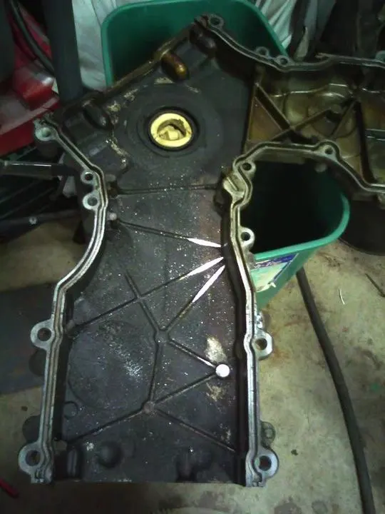

Do you know if those pieces of plastic ended up in the oil pan? If so it might be a good idea to pull the pan to clean all that chit out of there... otherwise you run the risk of the wrecking the oil pump
I think some of them did make it to the pan.. (that is going to be awful to pull in this truck)

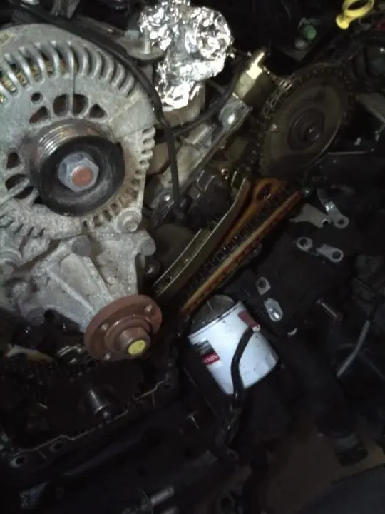

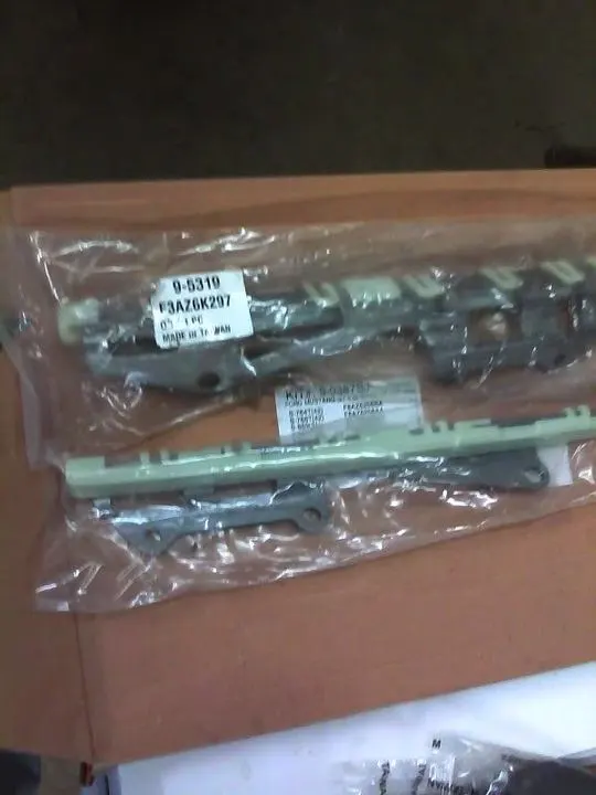

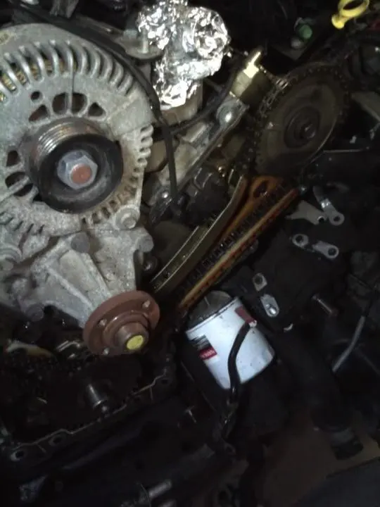

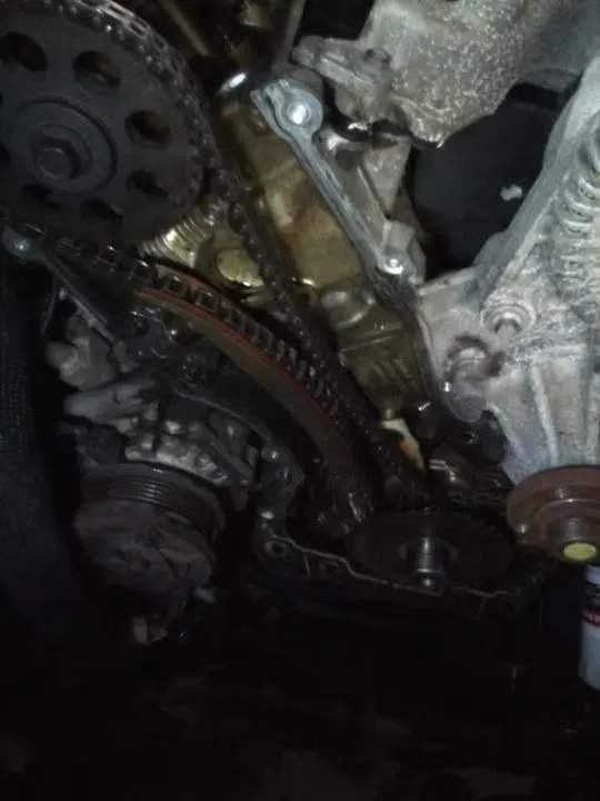

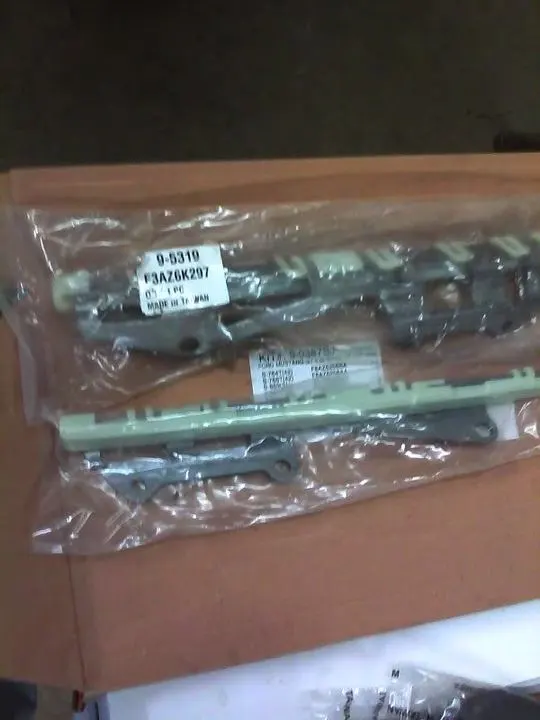

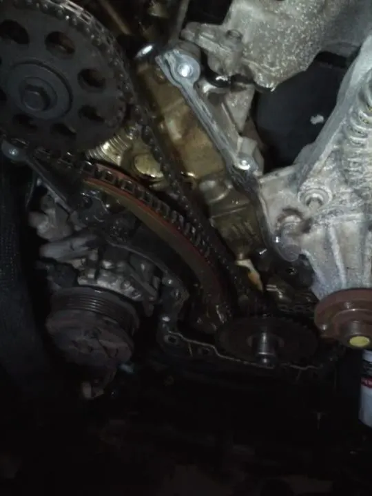

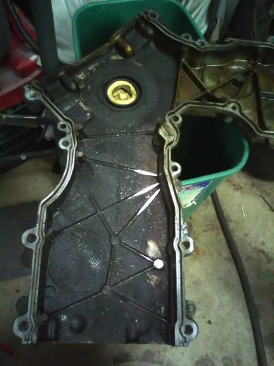

Here are some pics, I am also thinking I have the wrong timing chain kit, as the new tensioners look nothing like the one on the truck...

Those are the Trick Flow guides and should work just fine (I just installed the same set in May on my car). IIRC they come with both the 2V and the 4V guides (should be 6 guides total) and you end up using only 4.
Can you post pics of the timing guide that was broken?
