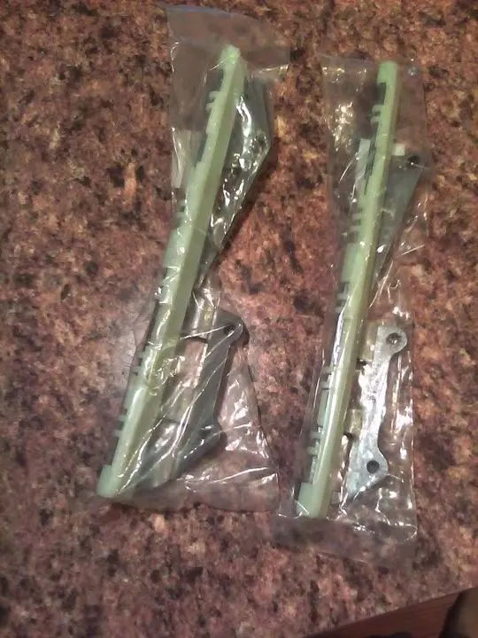

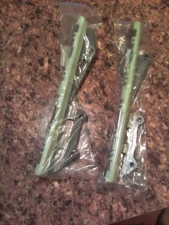

I checked and I have 4 tensioners, the 2 curved ones match perfectly, but then I have these 2. Is that for the wrong engine? I didn't get 6.

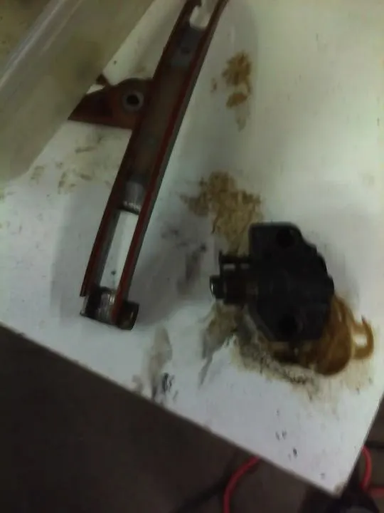

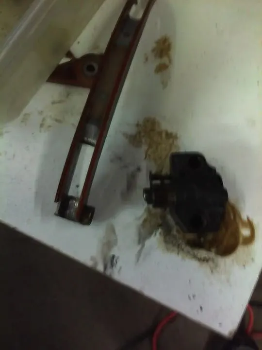

Here is a pic of the worn tensioner guide and tensioner.
The end of the tensioner is worn
