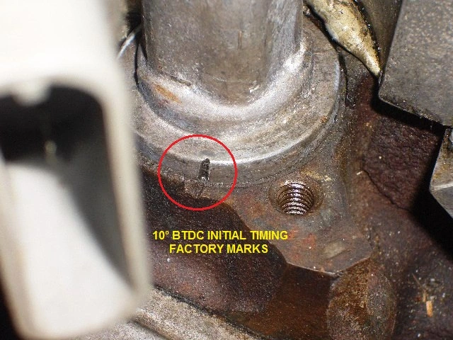

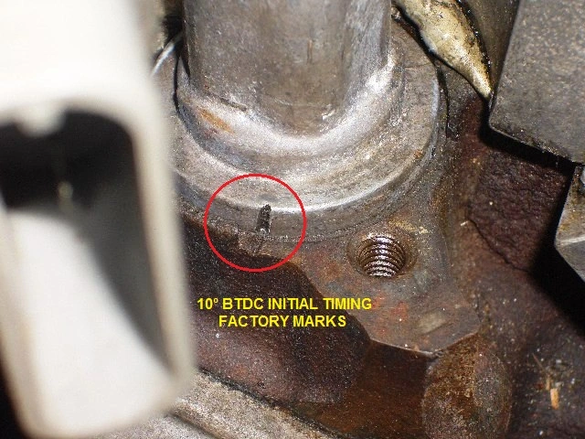

If you don't have a timing light and it is the stock intake and distributor, Ford made an arrow mark on the intake and a small notch mark on the lower distributor shaft . If you line them up you will be at 10 BTDC.
