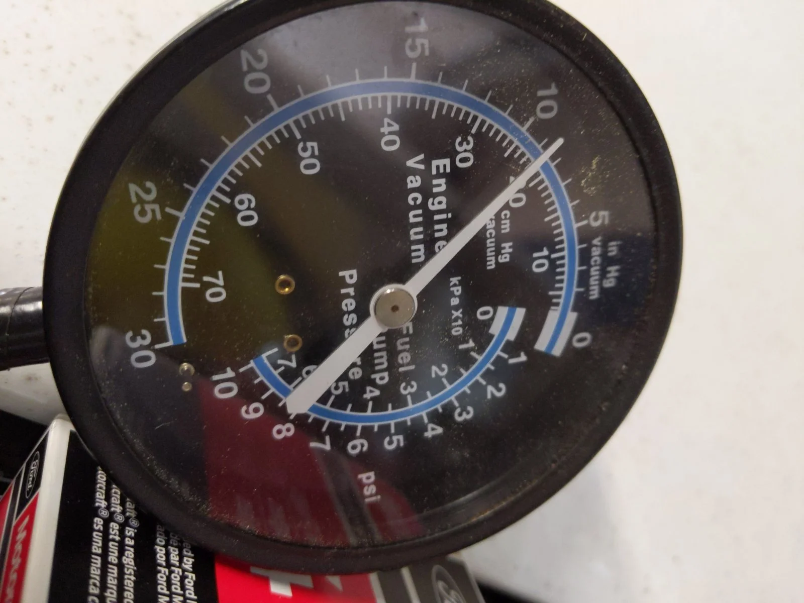

so i got it to running at 14deg btdc and I dont remember if i said this before but someone removed the throttle stop screw so i had to fiddle with it and the IAC to get it running but it seems to run ok and idle at about 750-800rpm i know i have a MAF Code and Intake Air temp sensor code, I did change the Intake Air temp sensor so im hoping that solved that im fixing to check the MAF. Ill try to upload a video of it running later maybe yall can hear/see something i dont,which im sure you will,lol. Its not pretty not does she run pretty but its got good compression and i want to get her back to looking and running like it should.
Got a Video. Sorry about the last bit was trying to get Camera to see timing mark but didn't work its at 14deg btdc anyways also a few pic of the Vacuum coming off the intake manifold

Vacuum looks low. Sounds funny to me.
