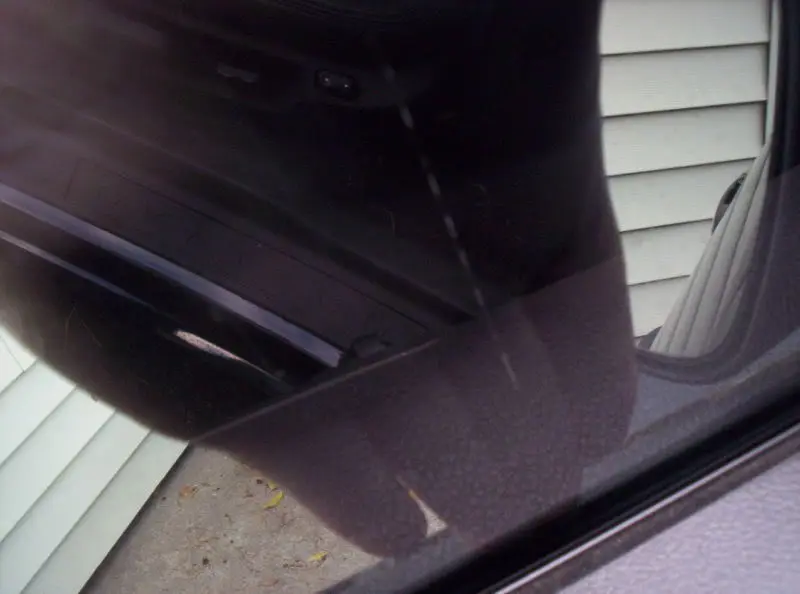

it is commonly referred to as "moleskin". it is a soft fabric that goes in between the glass and the interior door panel felt strip. without it, the tint WILL SCRATCH!! i called all over about a year ago when i had the tint done. no one local had a clue about the moleskin, and "never had any issues with the 05+ mustangs". well, my tint is scratched in many places. it looks the same on both sides, so it is an engineering problem, and not simply dirt in the seal. i will take some pics when i get off work, and show you what i mean.

U.M., here is one scratch. they are very hard to photograph. look at the line near my middle finger, that is a scratch. there are many more, but this one photographed the best. it did take quite a while for them to appear. i thought i was safe for a long time. :(
