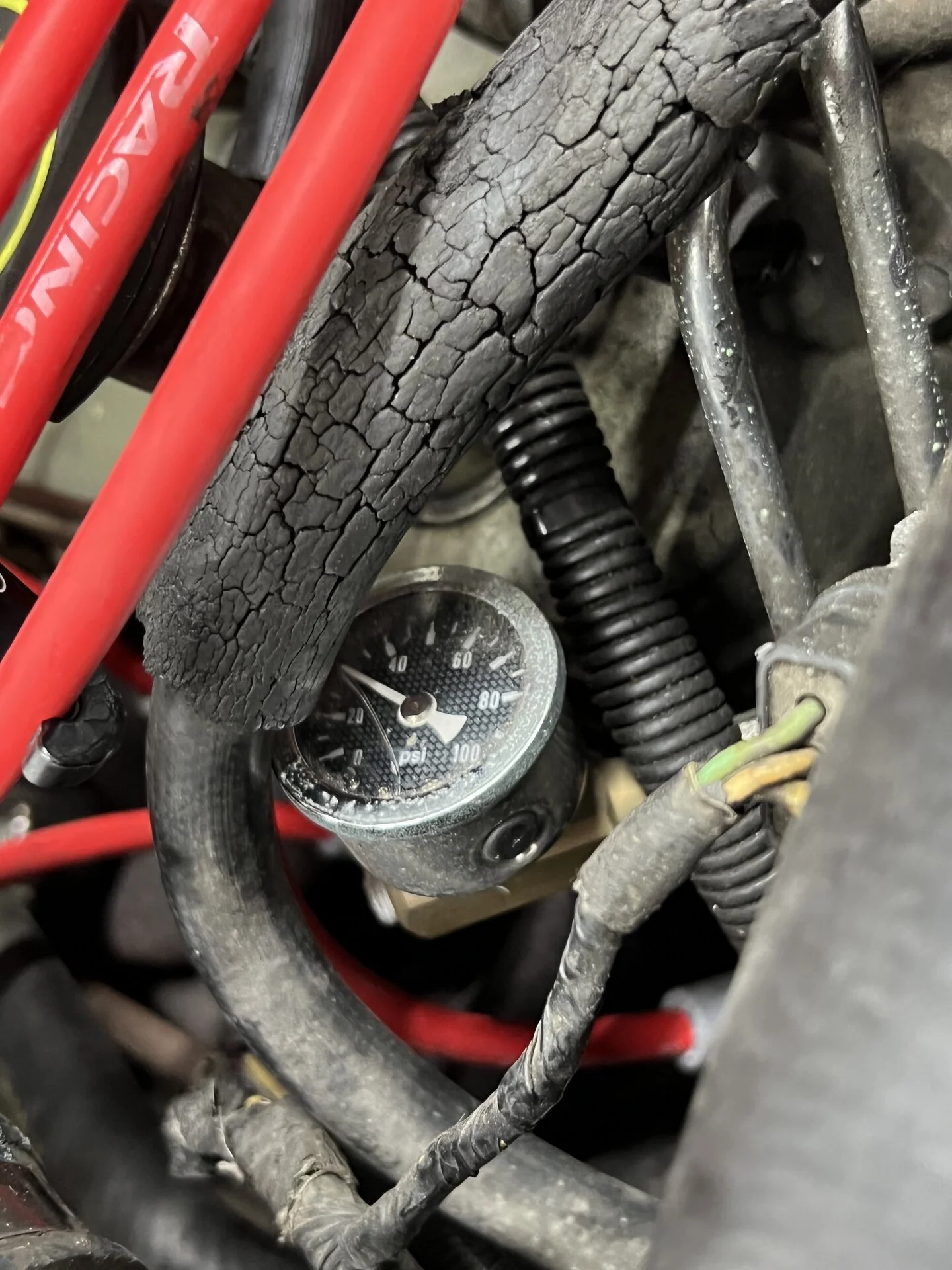

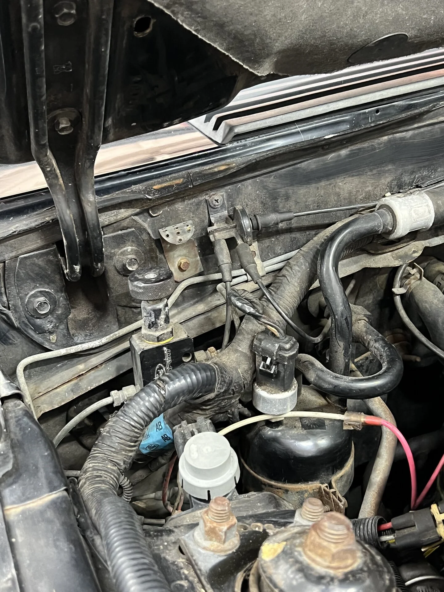

So I did it and the clutch engaged and began spinning. I’ll take it to get recharged whenever I get the car on the road. Also, if any of you could help me out, the car has a gauge connected to what I believe to be the fuel Schrader valve so I assume it’s a fuel pressure gauge. It reads 30 at idle and correct me if I’m wrong but shouldn’t it be 40? The car has what I believe to be a fuel pressure regulator on the fire wall but I turned it and the fuel pressure didn’t change. Any info would be much appreciated.

With the engine running, the pressure would be around 32-33psi. You need to pull the vacuum line off the fuel pressure regulator (located behind the intake “neck”) plug the vac line and read the pressure then. It should be 38-39psi. At idle, with vacuum connected the pressure will be slightly lower.
That knob you were turning is not for fuel pressure, it’s for the rear disk brakes. It’s an adjustable knee-point valve. It regulates the flow of brake fluid to the rear calipers so that you don’t get too much initial pressure at the rears. Hopefully you didn’t play with it too much.
