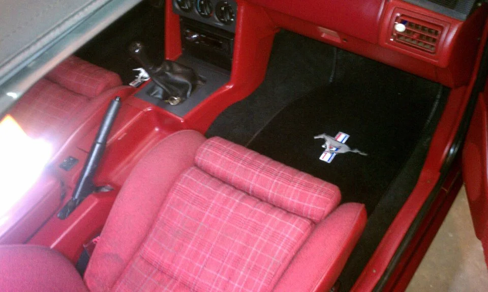

Well finished with the carpet install. Scarlet Red interor with black carpet is awesome. Thanks guys.
