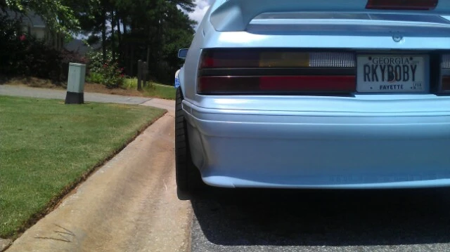

I have 5.71 17x9 gt500 wheels with 275 and they rub. Is this because backspacing. 2013-7-19 275s.webp

Nothing is a sure thing when the tires are that wide. I'd bet under certain circumstances they rub somewhere and there will be a possibility of losing the quads completely.
