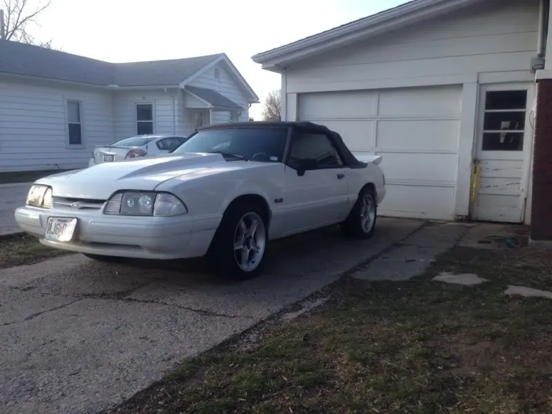

Ok. So the only thing left to do is replace my tires and I'll be driving my 92 on Saturday.
So I'm researching what size to go with, and I want to keep my quad shocks. And I keep seeing tires that are set up
255/40 rear and 245/45 in the front.. The. 45 is a taller tire right? Is there a reason for this?
Cuz I'd rather have my rears be taller/wider than my fronts. My front is too high as it is. The rims are 4 lug 17x9 cobra r's.
As of now I'm thinking 245/40 in the front and 255/40..
Not sure if. 235/40 would work on the front and 255/45 in the rear.
I've never ordered tires.. Sorry for the noob questions.
I think they are 245/45 in the front and 275/40 in the rear. I'm fling 255 in the rear so I can install my quads. But the front is way too high. I know the tires will only do so much but I don't wanna do springs till winter.

My quads are currently removed and I have super bad wheel hop even with aftermarket control arms. But my main question has not been answered, is there any reason I would want/need the taller tire in the front? Otherwise I'll be going 40's in the front and 45's in the rear. I'm looking at the stance of the car and less of how the tire looks on the rim ( for now).
You won't want a 40-series tire on the front, unless you plan on going with 275's. Anything else will be far too short. You still want to keep the stock over all diameter. A 245/45/17 is the stock tire height for a 17" rim. Unfortunately, because you have 9" wheels and 245mm tire is going to be really stretched on there. A 255mm is a little better, but it's still just barely square and it does an about 1/4" more to the ride height. You don't "need" a taller tire, but that's just about your only option in a 45-series tire if you want to increase the width. A 275mm tire is the best match for a 9" rim and in a 40-series tire it would allow you to keep the stock diameter, but it's unfortunately too wide for the fox's front track. It's going to get you some major front end contact unless you make some heavy modifications...especially if you lower the car.

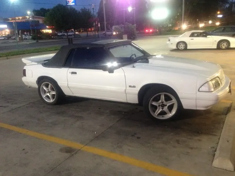

I'm starting to get a feel for it all now. I'll look over the math and make a decision and post pics tomorrow. Again, I'm just tossing on cheap-o used tired to get me through the summer , I gotta start driving this think or it's gonna kill me. That said, I'm already collecting parts for my winter project, I'll be dropping it down and going 4 wheel disk ( already got the Tc rear brakes) and newer( smother) shocks, so once all of that is done, I'll be dropping some real cash on good tires.
