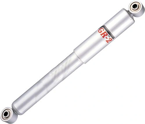

Lemme start over- the KYB's aren't the same all the way down but they're still too fat to flip I beleive. When people say flip em they're think of the style w out the dust cover on both ends. Look at the pics and compare.
Oooooohhhhh I see what you mean. Yea. Shoulda orderd te konis lol. Jk. But yea I was thinkit in my head it didn't see like it would make much difference if any lol.

Gabriel sells oem style for like $25 each if you can't get the KYB's to fit and I doubt you'd notice a performance difference between the pair.
