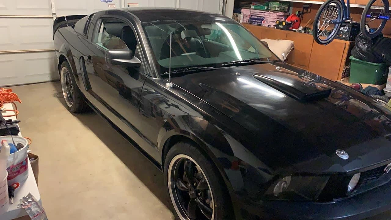

Hey everyone,
So I got myself a staggered set of wheels 19x8.5 front and 19x10 rear. What size tires should I get for this setup? For bolt ons I have JLT series 3 cai and frp 62 mm throttle body I do plan to install some Adjustable coil overs in the near future and maybe some cams as well but that’s further down the road. Thanks in advance!

I got them already, thanks. I got
Firestone Firehawk Indy 500 245/45R-19
Firestone Firehawk Indy 500 275/40R-19
