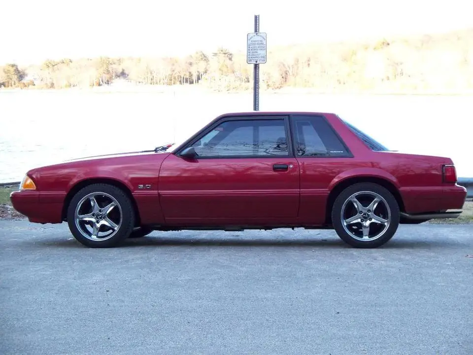

okay, so as some of you may well know, i'm a n00b when it comes to certain subjects haha, namely brakes and suspension (but i'm reading and learning!)... can one of you gurus on here please help me figure out what size rear tires i want to order for my coupe?? how tall, how wide, etc.? i'm thinking of going with the Nitto 555r's since the car is street driven and i don't want to have to buy tires every 5k miles
the wheels are 17x10 with 25mm offset... and yes, i'm removing the quad shocks
thanks in advance for the help
Chris :nice:
here she is with the old 17x9 cobras just for reference, note: the car will be getting an eibach prokit and tokico blues along with the new wheels and tires

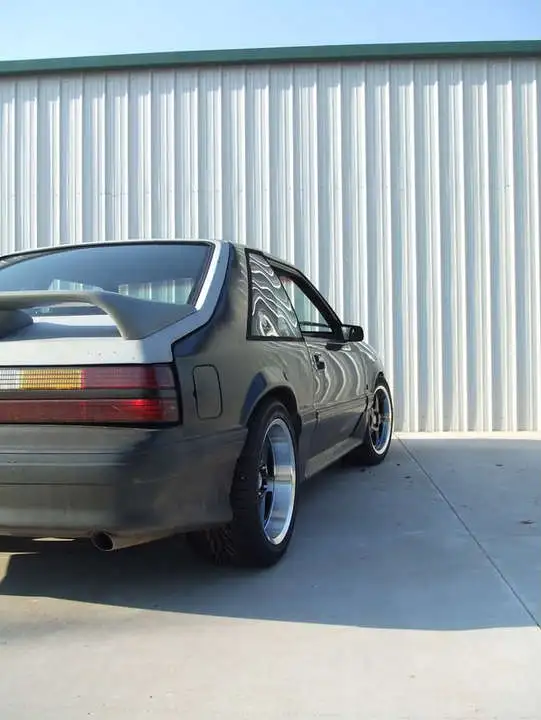

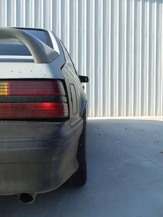

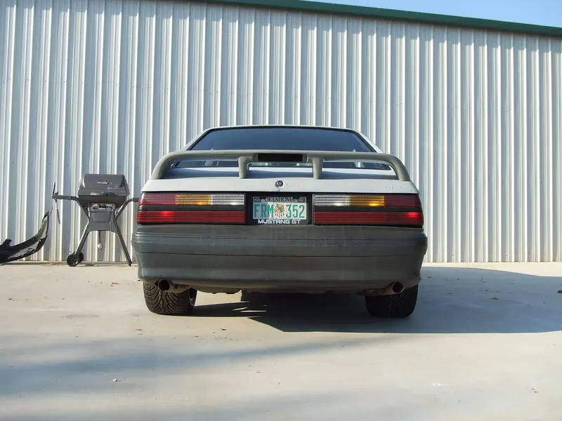

These shots make me want to run deeps in the back and 9's in the front. I have 8's in the front right now and 9's in the back. Those deep dishes are sexy as hell.
