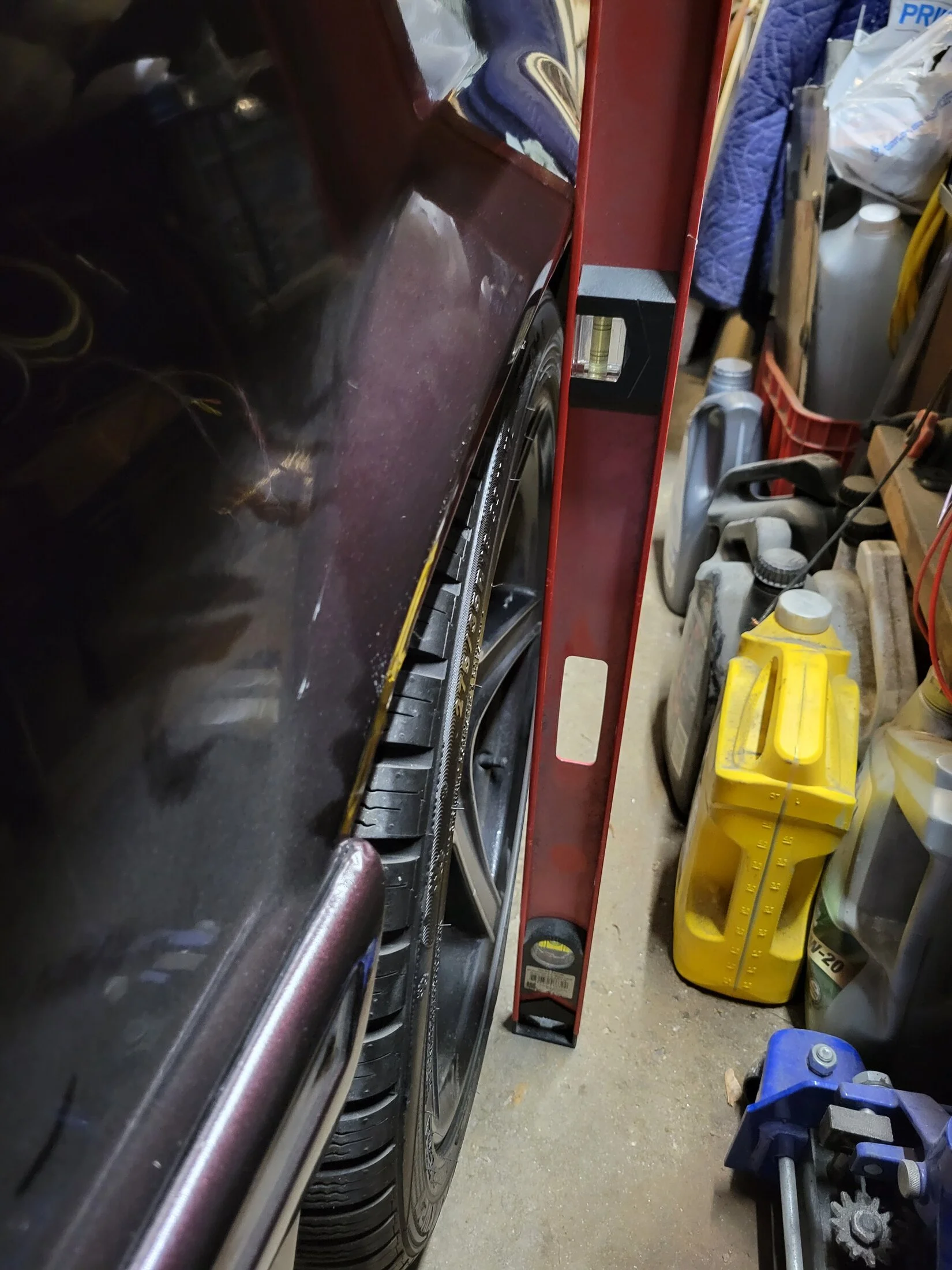

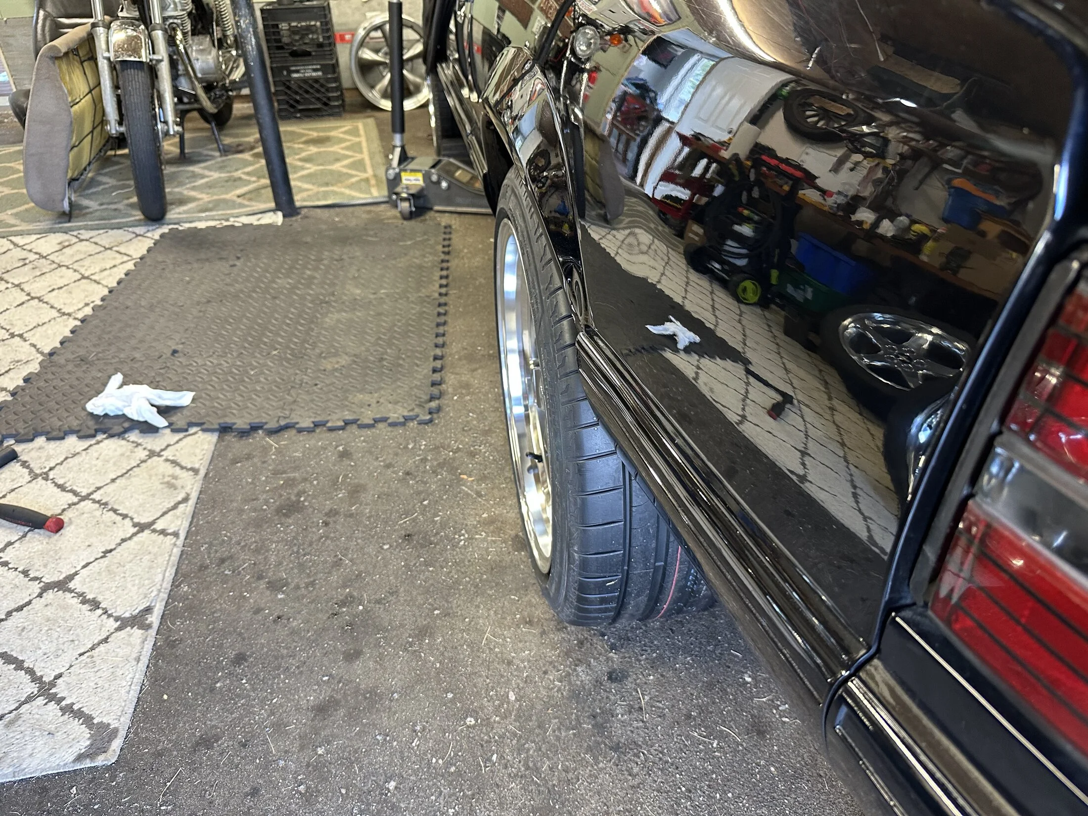

I have no issues with tailpipe clearance. Flowmaster 2 1/2 inch tail pipes.Hows your clearance on the tailpipes out back? Only thing i'm really worried about right now.

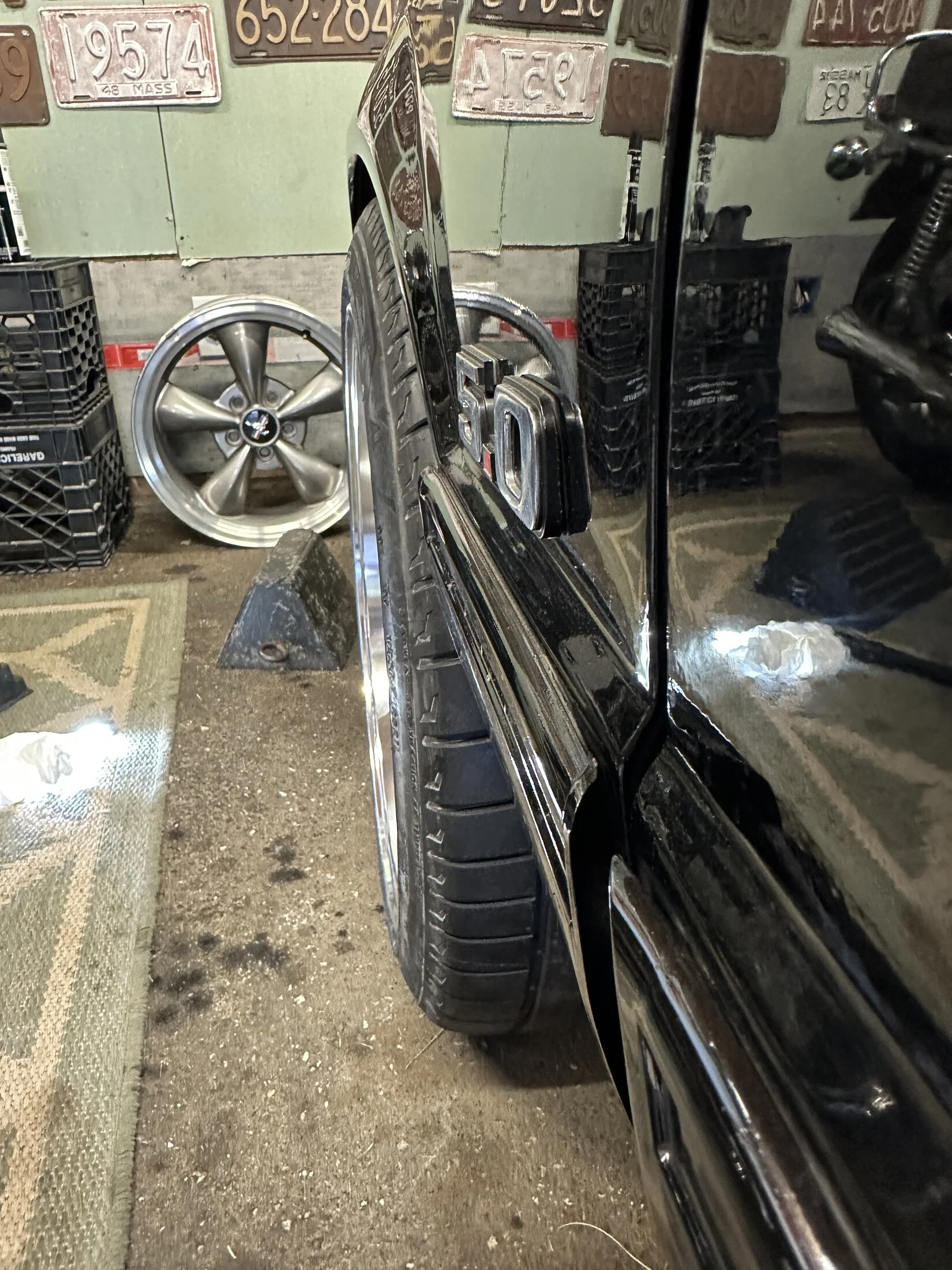

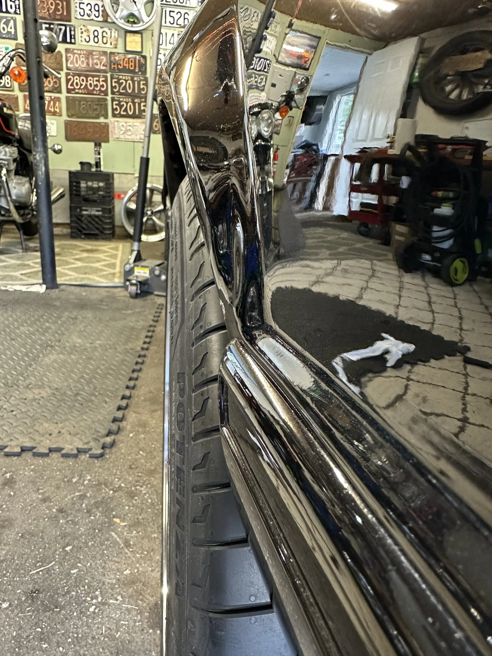

Do 275s on a 9” wheel bulge, or are they fairly square?

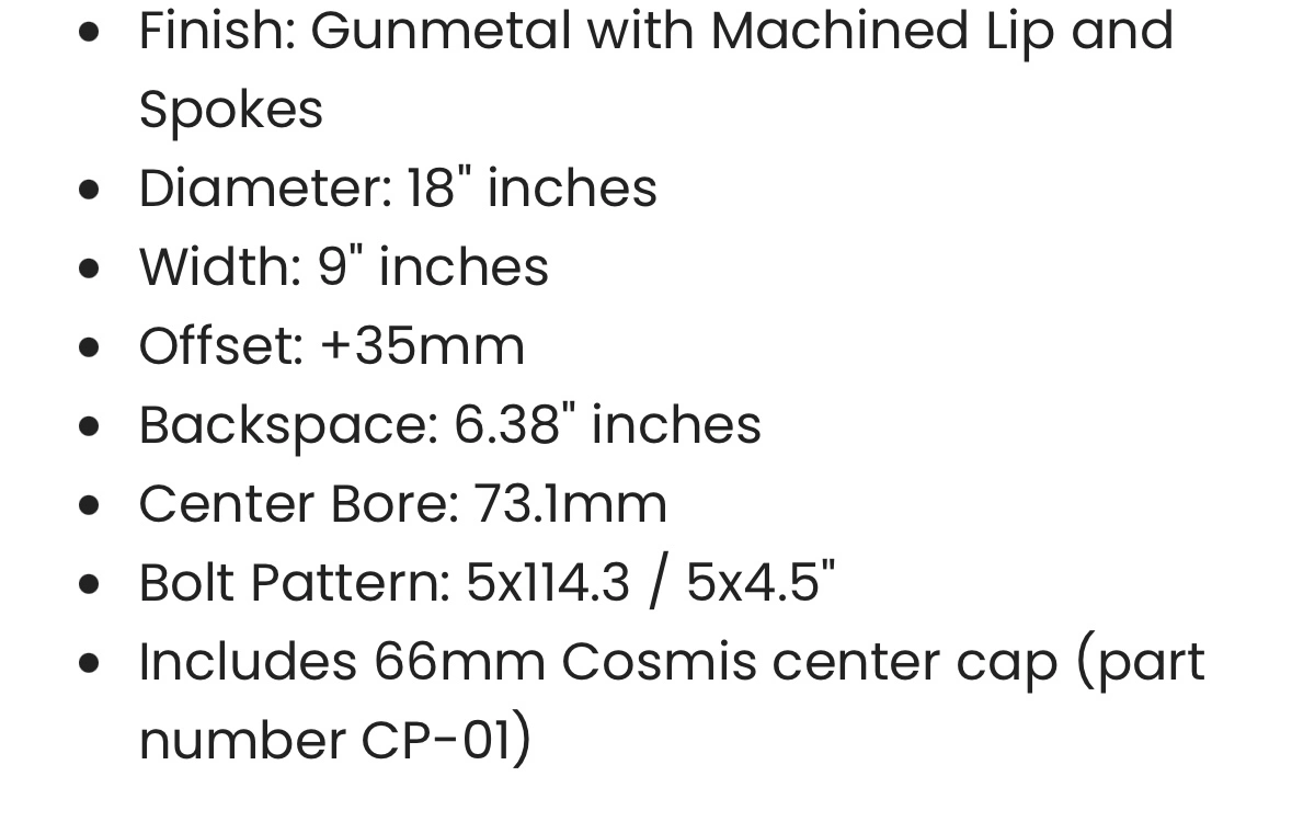

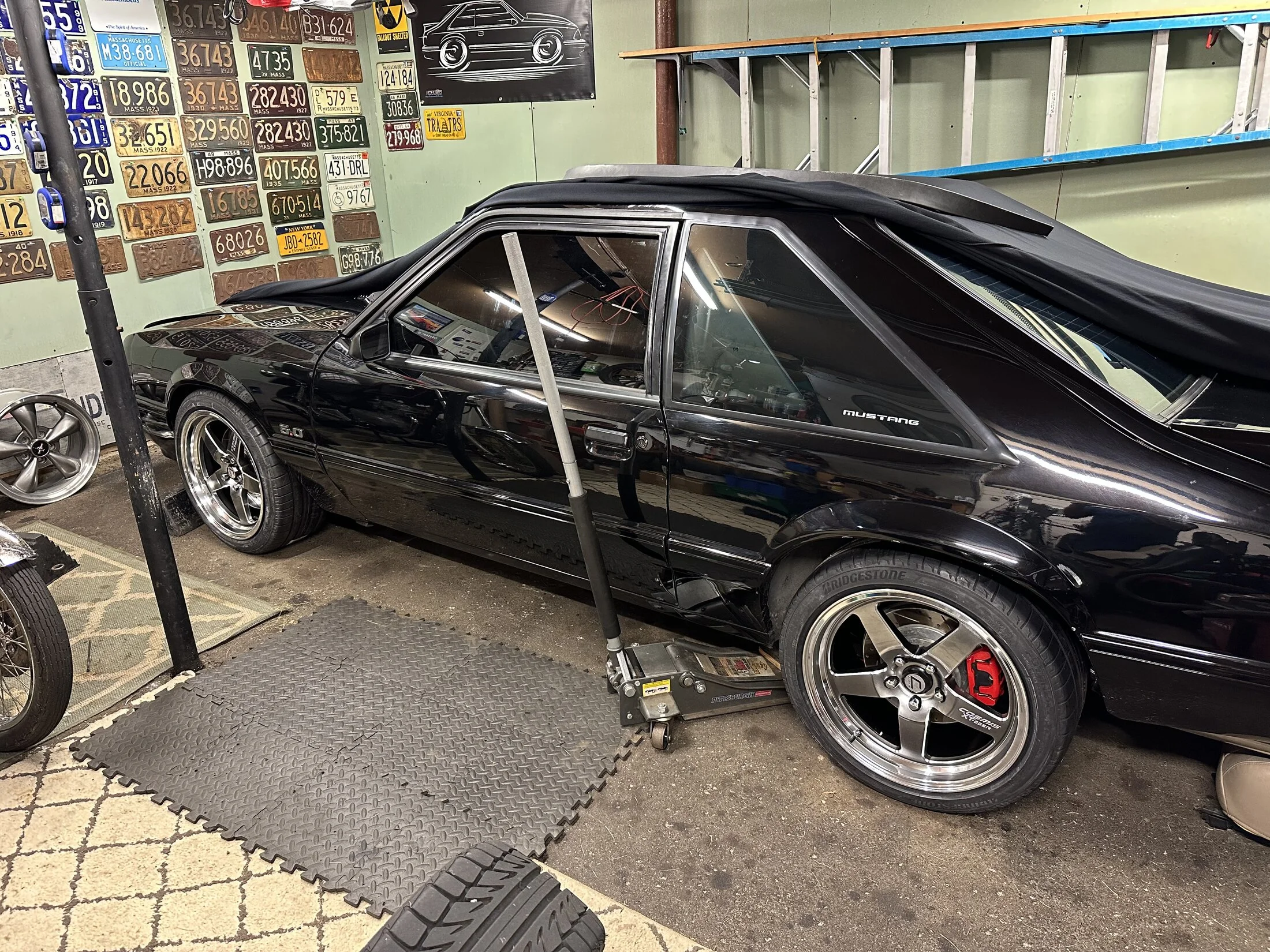

I think you will need 14mm of spacers to get your rim positioned where mine is.Out back, i think i'll buy a stack of washers and stack them on the lugs to simulate a 1/2" and 3/4" spacer.
