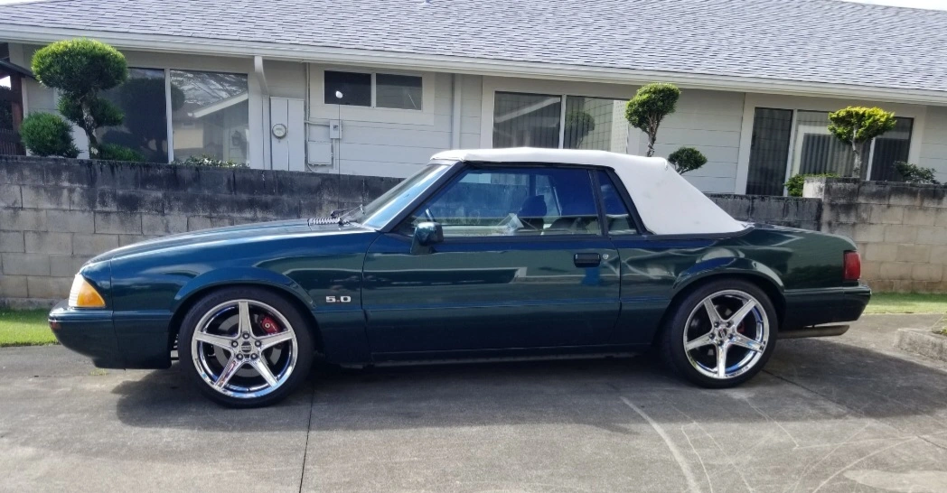

I have 255/35/18 on the front (25.1" OD) which I like because it is shorter than stock and with the 255 width I don't get any rubbing on inner fender.

You can see how it fits on the rim.
I'd think twice about the 255/35/18. It's not enough tire and you need to make the car really low to fill the gap.
It's only 25 inches tall. I ran a 225/40/18 which is pretty much the same height and i hated it.
I switched to a 235/40/18 and honestly that's not enough either. Especially when you are going to probably run a 275/35/18 in the rear.
So now you are lower the front because the gap is too big and you have tall tires in the back.
Not only was the gap too big with the car leveled correctly, but it looked like i had all this meat on the back and rubber on the front.
If i had to do it again, i would go with a 245/40/18 or for you whatever equals that height.
Remember, pony wheels had a 255/55/16 which is like 25.7. That is actually a good height, it's just too much sidewall because of the 16 inch wheels.

My pic above is exactly that tire combo 255/35/18 in front and 275/35/18 in the rear. I have a pair of 285/35/18 I will be putting on soon.

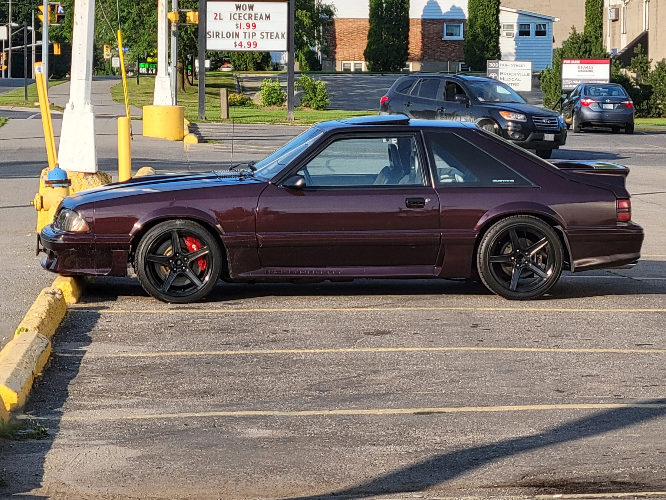

If i remember correctly I think @Mstng93SSP got it right with the tire sizes on his 18's and has pics around here somewhere.
Or maybe he will see this and post.
