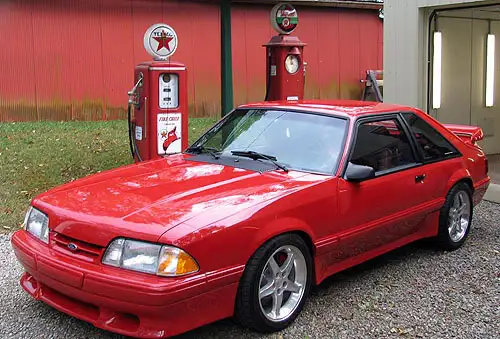

Alot of factors in play.. but this is 245/45/17 and 275/40/17 w/flipped quads...

I want a tire that will fit without modications. My car is dropped probably 1.5-2" so I was thinking still running 235/45/17 up front with 255/40/17 in the rear.
Na, that's too small. I bought the 275/40/17 on a 2" drop car and they fit fine, no rubbing. Really wish I had got the 295's. Something does rub if there is somebody in the back (adult) but that's not very often and I put really soft springs in the rear that's when it started rubbing.
