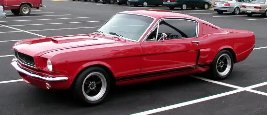

Here's my '65 with 225/50/15's on all 4 corners. My wheels are, also, American Racing Torq-Thrust D's - 15" x 7".
Global West UCA's with Shelby drop mod and no rubbing.
Tim

im guessing wrong offset for a 195 to rub
