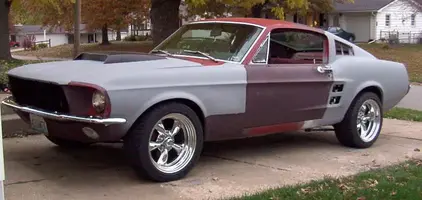

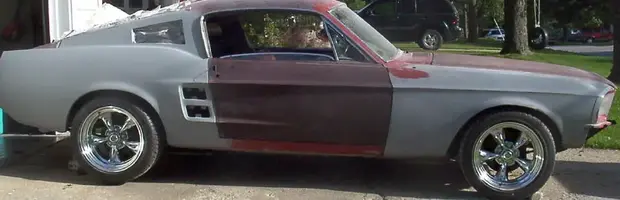

I've got 17x9.5 on the rear of my 67
I've got 17x9.5 on the rear of my 67 with 275/40s and 17x8 on the front with 245/45s. I can get some photos tomorrow if you like.
John

Photos
This is work in progress. I have more

John,
what are the offsets of your wheels in back? where did you get them from? I like the way they fill out the wheelwells, that is just the look Im hoping to get, are you referring to the offset when you say backspace? and is that on the front and rear, or just the front? thanks! nick
Wheels
They all have a 4.5 inch back space that is measured from the mounting surface to the inside edge. I guess there is 4.5 to the inside and 5 to the outside of the rear wheels. I have 1" lowering springs on the front and they have rubbed when hitting a good dip in the road at speed. I'm not sure how much I can go inside on the front. The 17 " wheel will clear the upper ball joint where the 16" will not. I don't remember how close they are to the frame when turning. If there is room there I would go with a 5" backspace. I bought them from MTO Tire which is a local dealer. I had them made special with the 4.5 backspace. Cost was $350 each. The model is AR 405 Torq Thrust II with crome center. They will make any backspace you want.
Those tires are awesome!!! You were able to get 17x9.5 in the back!!?
What tire width maximum could you get back there before any rub at inner fender or outer? If the care were lowered, say 1.5" - 2"in the rear, would there be an issue with rubbing? :nice:
Hood Scoop is Boss 9 repop. I needed something that would cover the oval air cleaner on top of the 427 2x4 mr intake and i thought it would be a little different. It took quite a bit of grinding and sanding to get it to fit the contuor of the 67 hood. It's probable 3/8" shorter now.
The springs are new from Mustangs Unlimited. Front are 1" lowering and the rear have 1/4" more arc than the proper springs.
If the inner wheelhouse was massaged a little at the front lip it would be easy to fit 5 or 5.5 backspace wheels. Then you might lower it. The lip on the wheel opening could also be rolled some. John
