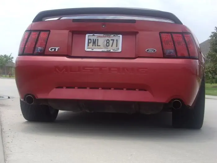

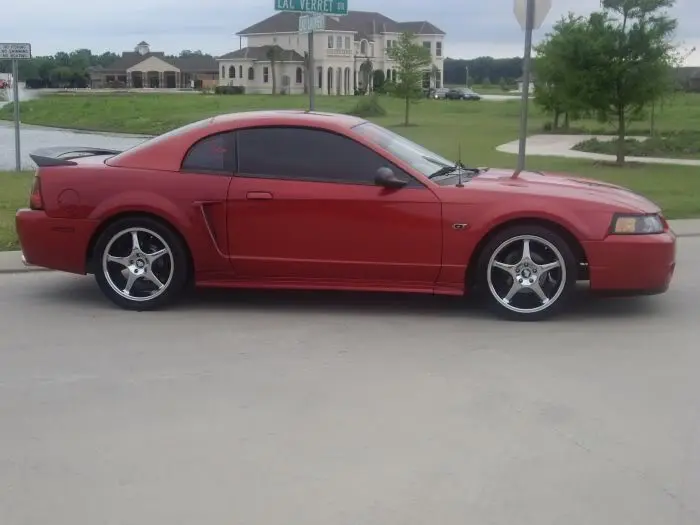

i have 18x9" rims and i have 295/35/18 goodyear eagle f-1 gs-d3 and they look perfect
i have y2k cobra r's
