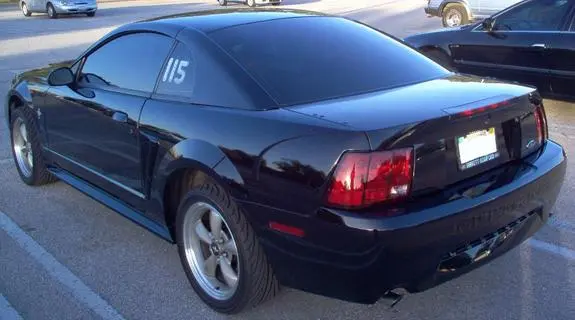

Stock on a 98 is 16x8, not 17x8. 9s will not rub, a lot of people on here have them. 9s would be in the 245 width range.
Bullitts are 17x8 and they take ~245 width, so 9's would take ~275's. My 255's on Bullitts are just about perfect in the front but I could use a some more in the back. Also, when turning slowly at full lock, my 255's rub in the front, and my friend's '03 Cobras 17x9's with 275's stick out a tiny bit in the front. So, 17x9's, assuming they are shod with 275's as they should be, may be too wide in the front. I know there is less width room in the back of pre-99s but I'm not sure about the front. You may want to check on that.
Edit: Here's a pic of my Bullitts with 255 Yokohamas just for comparison's sake.

those rims/tires look good in that pic. :cool: thanks for the info....i'll have to check on the size for pre99 stangs...somewhere....i dunno. who ever knew that this could be so complicated....lol so if i don't want rubbing in the front then i should get 17x8?
