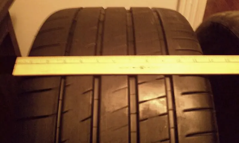

Funny thread, you are dealing with the same two issues I had with mine. Mine has the SVTPP wheels so replacements for the cool weather are tough. Ended up with these Michenlin Pilots.

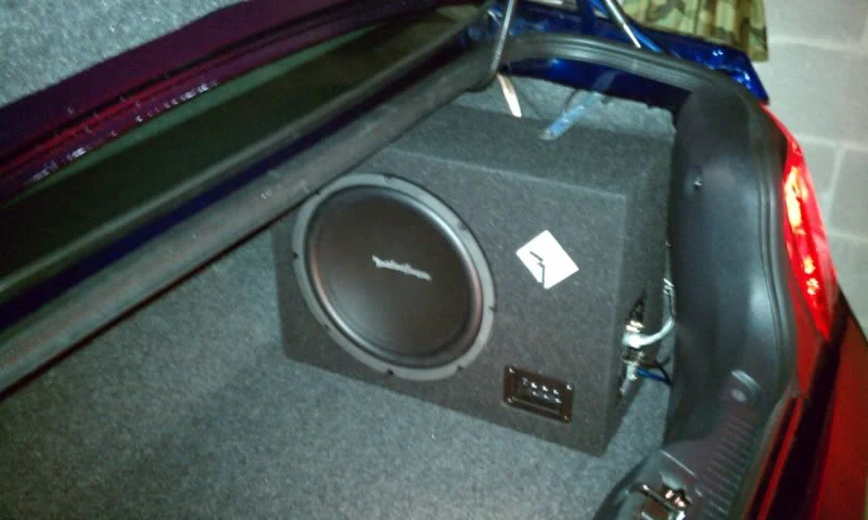

Santa brought this Rockford Fosgate 12" 300 watt sub enclosure and it put bass back in my Shelby!
