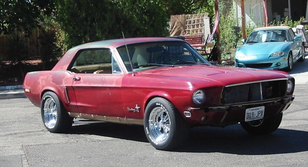

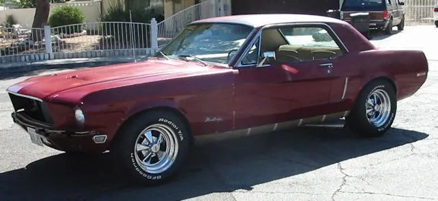

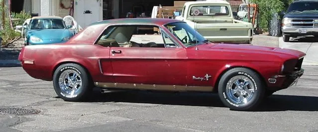

I had similar issues with multi fit or often called uni lug Cragar wheels in the 1980's on a 65 mustang and haven't used them since, its a pretty cheezy system to mount a wheel. While I suppose anything's possible with tires these days but I never had a vibration issue with BFG's and would tend to lean toward the wheels just due to the mounting method. Vibration issues aside, it sure looks like you don't have nearly enough backspacing on those front wheels, from the pictures it looks like the tires would rub the fenders like crazy up front and possibly in the rear too.
Thanks 4 The Reply,
Yeah, I mis-wrote, the pics show the 235/60/15's but I did need to downsize one size to 225/60/15, as they did rub a little. The 225's have been on there for a while with no rubbing (except a good dip turning into a driveway or...) after a wheel lip rolling. Good thing is that the occasional rub is against a smoothly rolled edge, so no damage to tire or fender. Yep, that mounting system is lame! I'm pretty ticked off at the dealer for giving me those (and at myself for not knowing any better at the time) when the direct drilled were available at the same price!
