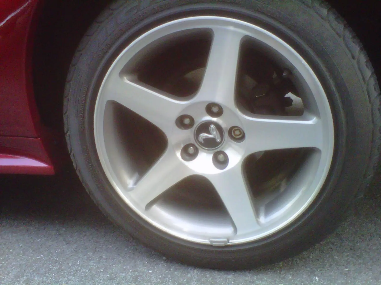

ok. i will measure rims tonight, i dont know size offhand- car is as bought.... but i do know it has 245-45-17 on it and the rims seem wider then the sidewalls of the tires. the sidewall isnt even with the rim edge, the tire kinda bulges out at the rim......

so i used a tape measure- hooked inside of wheel and pulled thru to outside edge of wheel and it was 10". i will look at backside of wheel for imprinted size....

If your current tires are 245's than your wheel size is most likely 8" wide. I would get the same size tires that you have now if they fit well. As far as brand there are tons of great recommendations above. I currently have 555's and for a street car they work out great, last a long time, and have good bang for buck. If your car is mostly stock than the nitto 555's or some other similar summer tire would be perfect for you.
