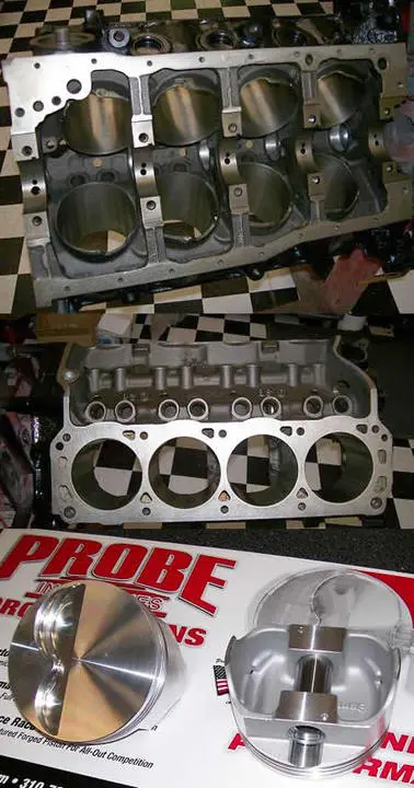

We are all still recovering from that terrible ice storm, but the block has been cleaned up, repainted.
The Pistons took FOREVER to come in. But they are here now and it's off to balancing.
