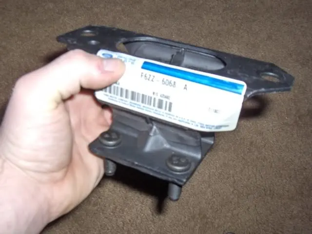

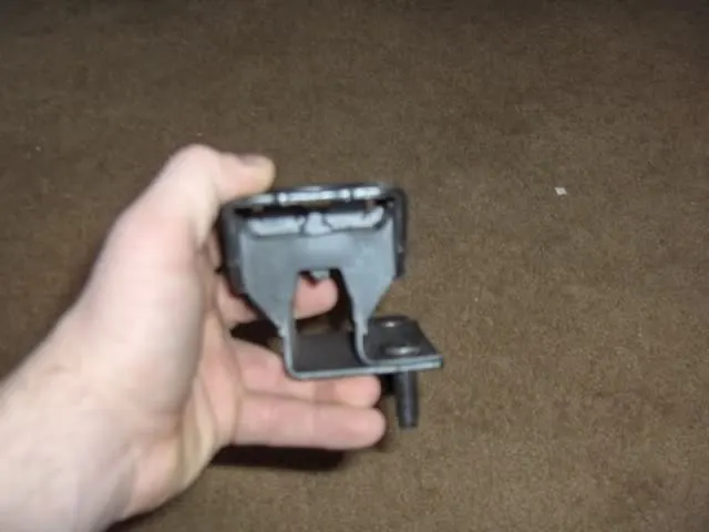

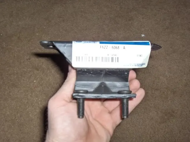

Ford part number F6ZZ-6068-A is a mount for a 96-98 2v transmission, it is offset and is what www.bieberfever.com sells with their tko swaps for our cars, I bought one and its going to work great, here are a few pictures of it...

see I called them and talked to them in length, and they said I just use the stock mount, and www.bieberfever.com said to use this one so i'musing this one so I don't ahve to elongate the bolt holes...
