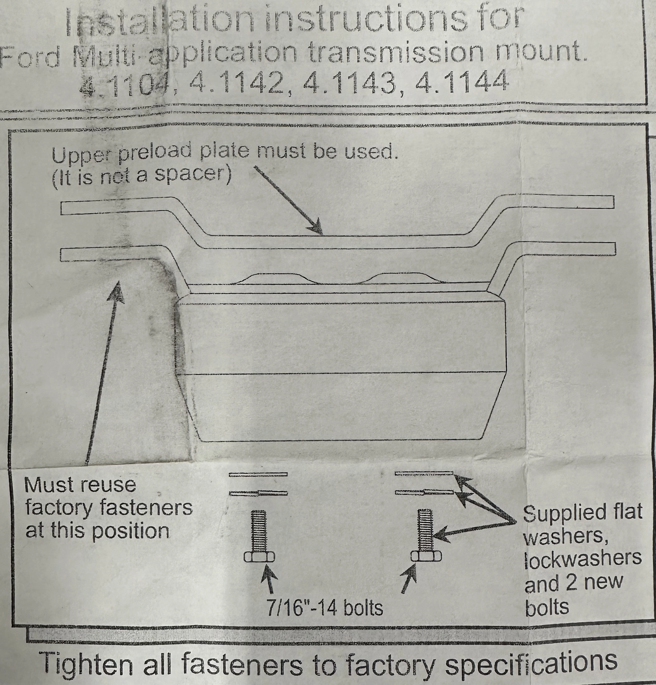

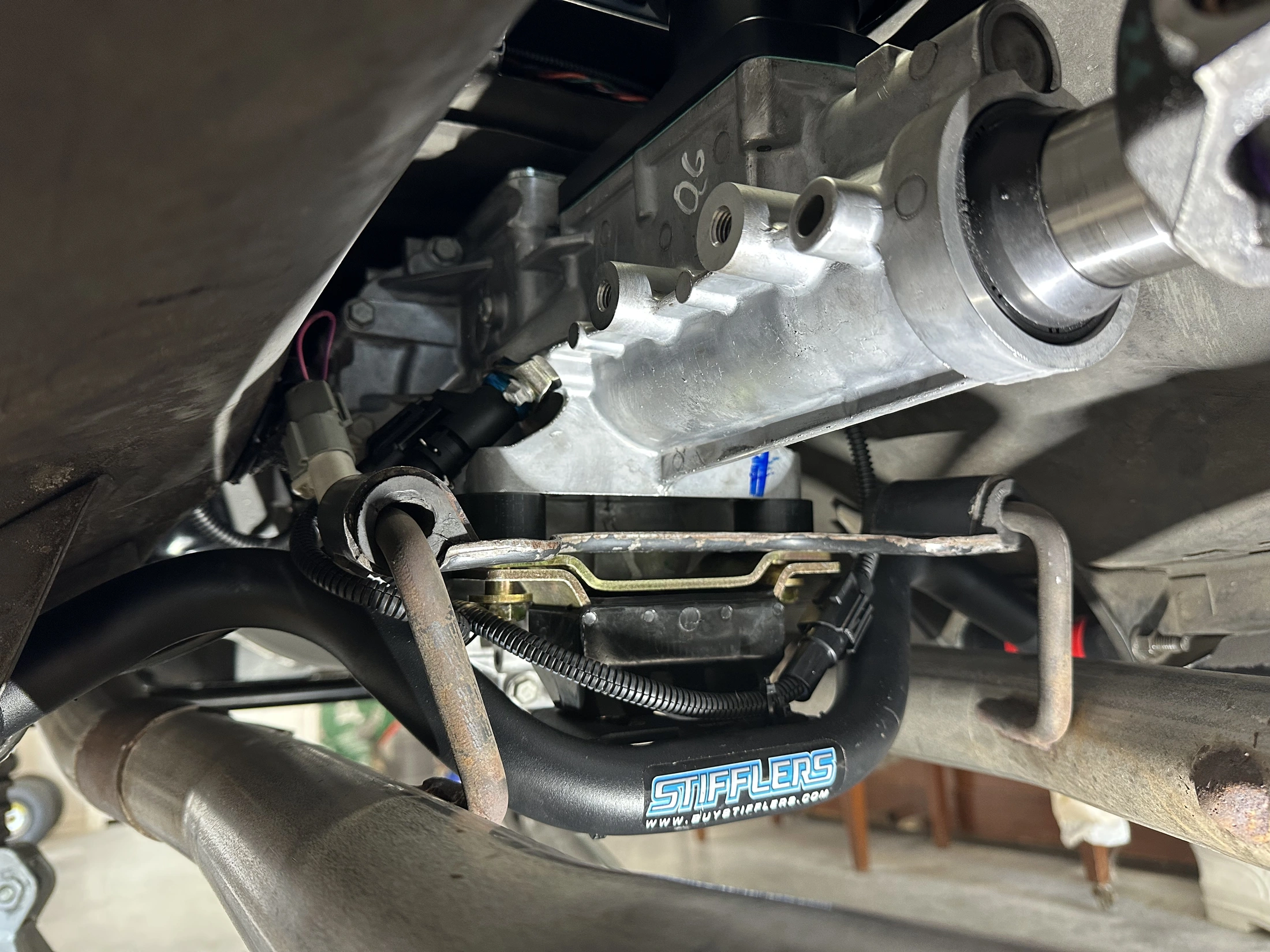

Started on the X-pipe and how I had the exhaust support bracket stacked between the trans and cross member was too low. So in my case the stack of parts between the trans and the Stifflers cross member is as follows:
Stifflers cross member, Prothane trans mount with the upper preload plate, then the exhaust hanger bracket, and then the TKX spacers from Stifflers.
I also had to slot the mounting holes on the exhaust hanger bracket 1/2” towards the trans mission. The exhaust would not move far enough forward without the slots. That allowed me to get the X-Pipe bolted up to the shorties and then get the cat back bolted up.

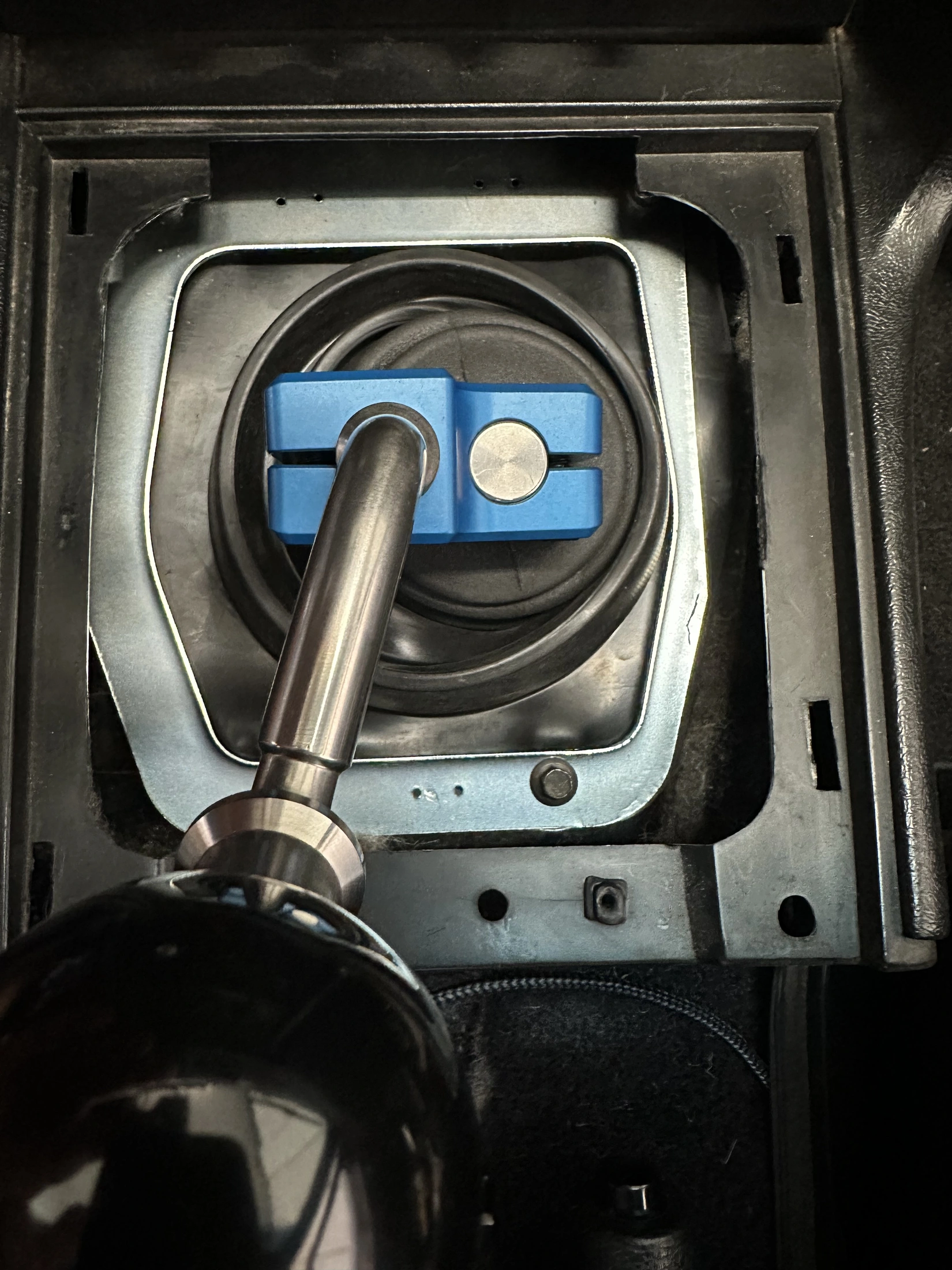

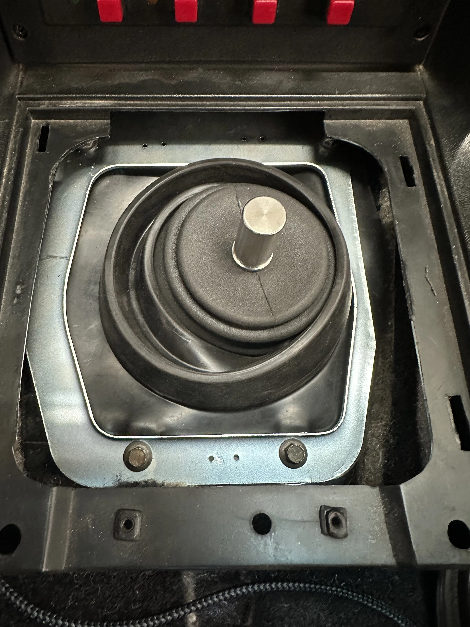

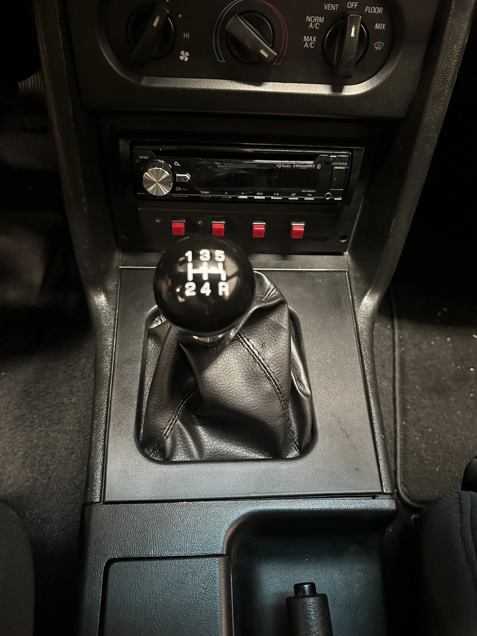

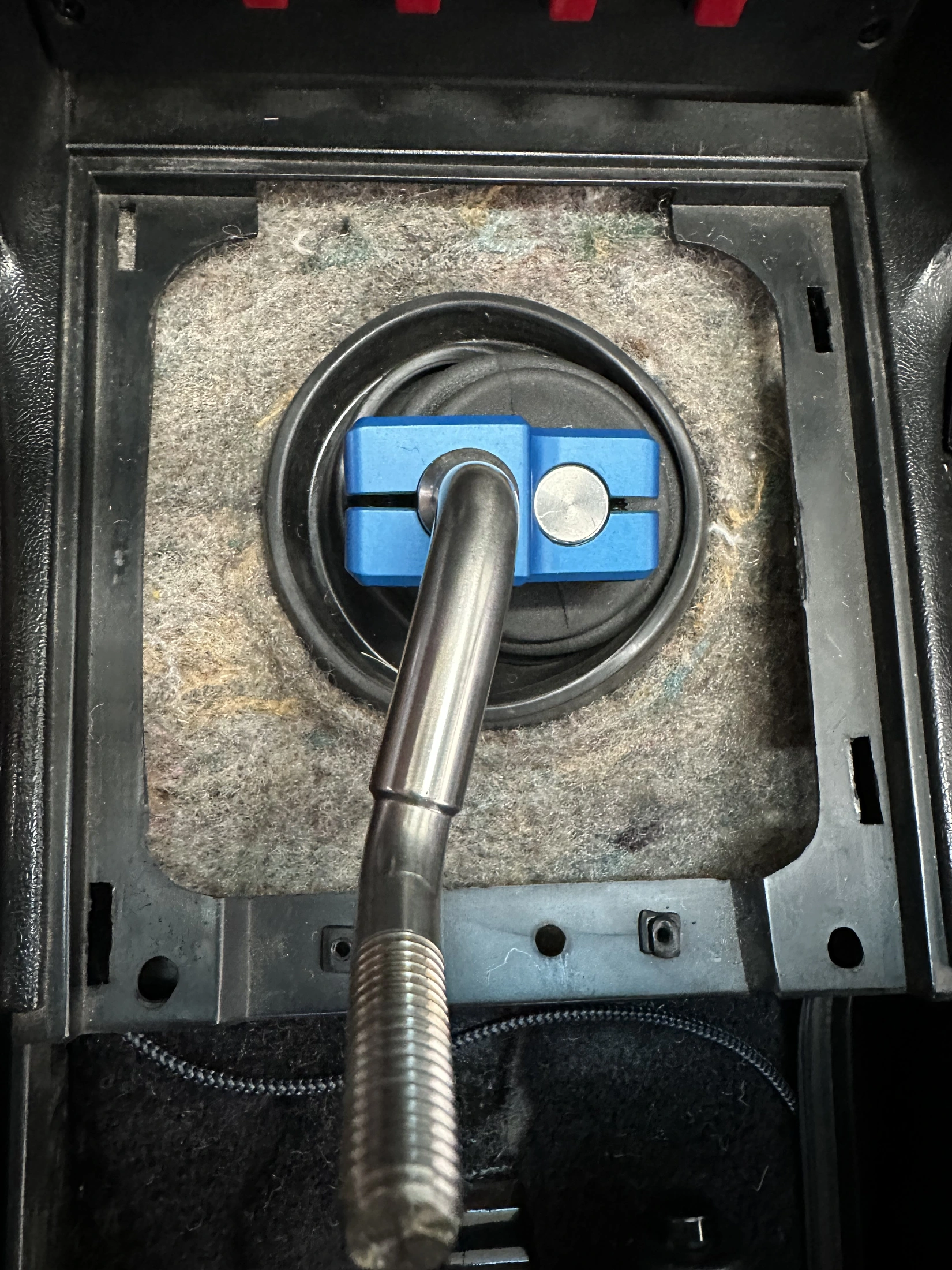

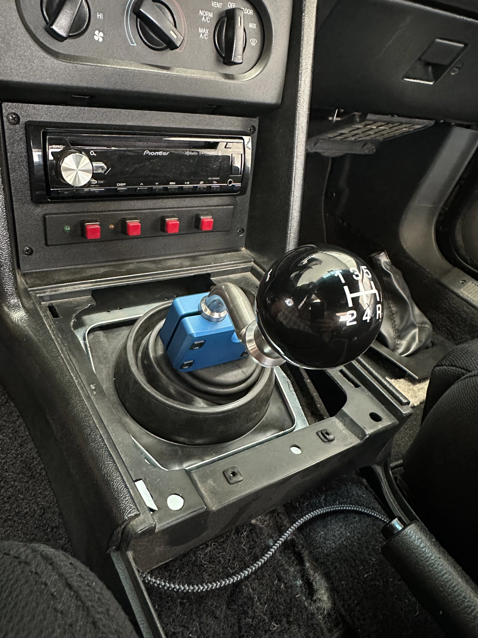

Well its been forever but work has finally subsided and I got back on it this weekend and we are done. Fired the motor up and ran through the gears on the jack stands (you hush your mouth) and everything is buttery smooth. Have some pictures of the MGW shifter installation of which you will notice the crazy offset to the driver side but the TKX moves the shifter about 1" to the passenger side vs. the T5. You can see here how I had to offset cut the new lower shifter boot to the passenger side. I hacked up the old one and figured out about what I needed to do then just to small cuts on the new one and got it where it needed to be.
Here is the shifter installed and you will see how I offset the base and handle to get it where I wanted it. You can offset the stock shifter handle on the stock Tremec shifter with a 1" billet block that you can find online and I believe eBay.
Trial fitting the MGW shifter ball
Shifter boot and center console reinstalled
And if anyone asks the two left red buttons are for the ABS and the other two were for my Mark VIII fan before I got the DCC controller so they do nothing now.
Anyhow, its done and now I just have to put about 500 miles on the new clutch and transmission before I can put the drag radials to work. I will be getting pictures of all the T5 stuff and will post up an for sale add for all of that here in a couple weeks. Hopefully someone close will want to buy it all as I really do not want to ship anything due to the high cost of all of that.

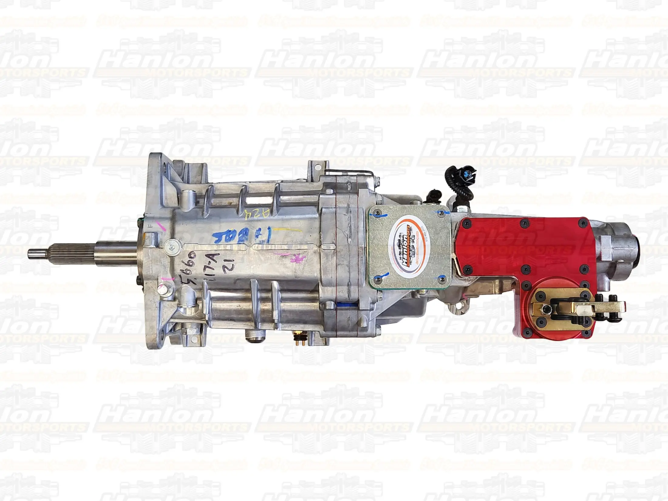

I have to buy a TKX like in the pic for my corvette , or I can get the C2 shifter separate and install it on a TKX... This one is from Hanlons..
