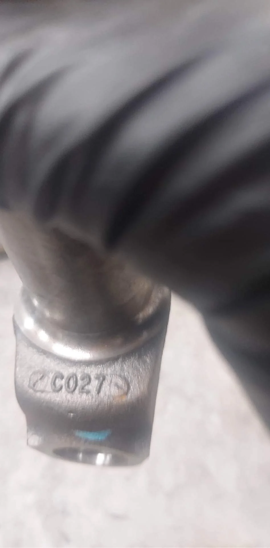

Tkx experts. Working on swapping out an aod to a tkx. The plan was to use the stock driveshaft. A 31 spline yoke came with it. Its markings are spr 1089 and c027. I need to get a new u-joint. Do I need to use a standard u joint or the 1330 or the hybrid?

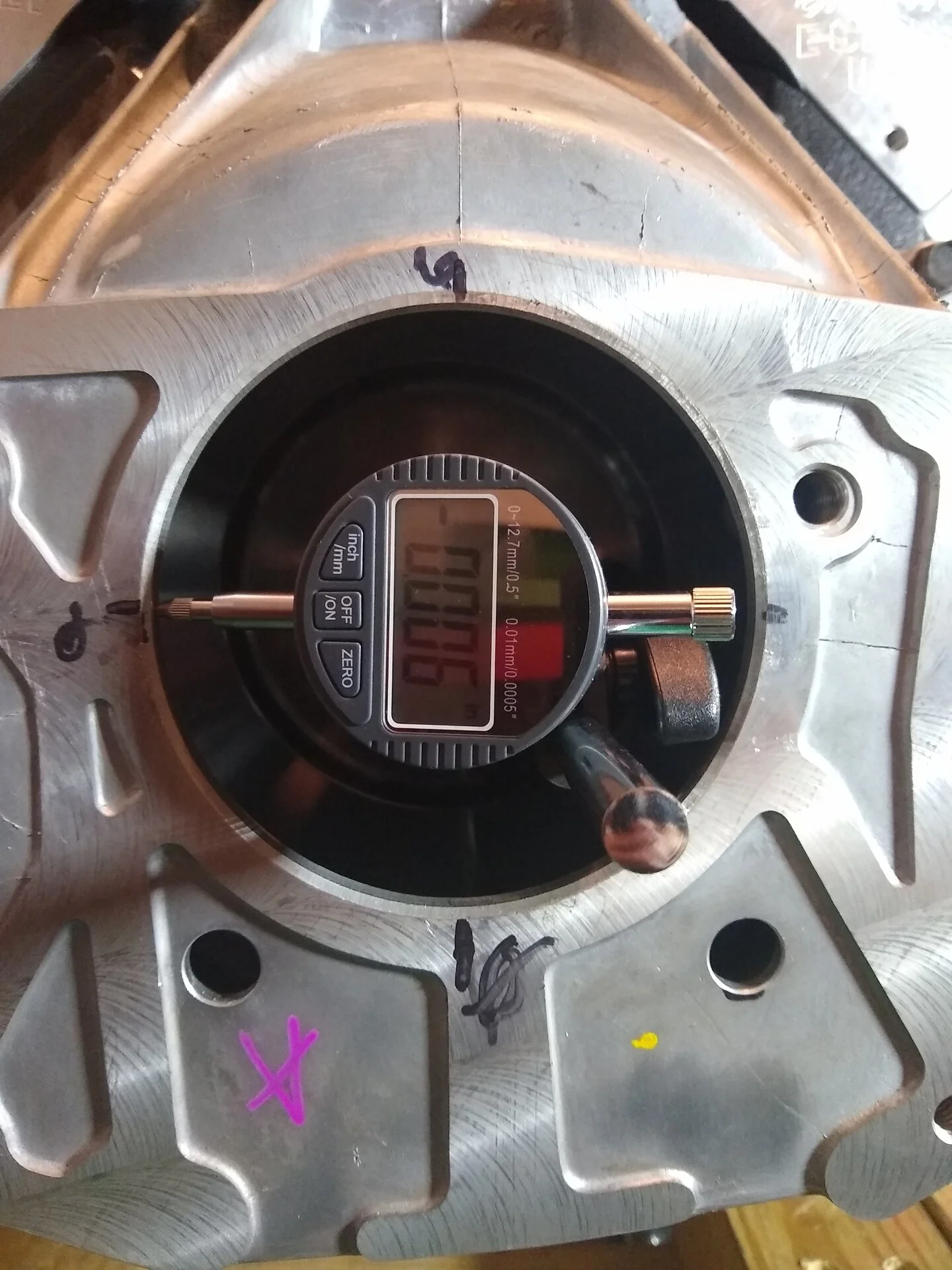

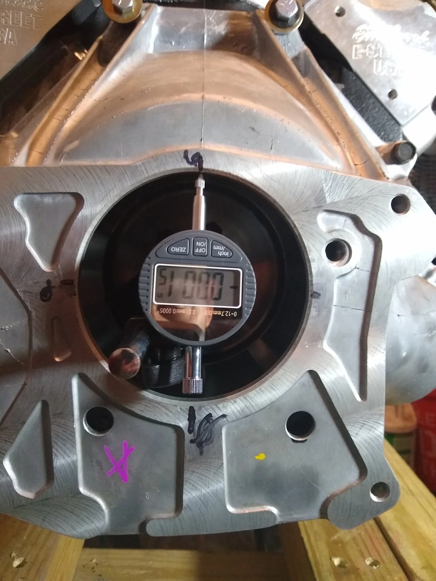

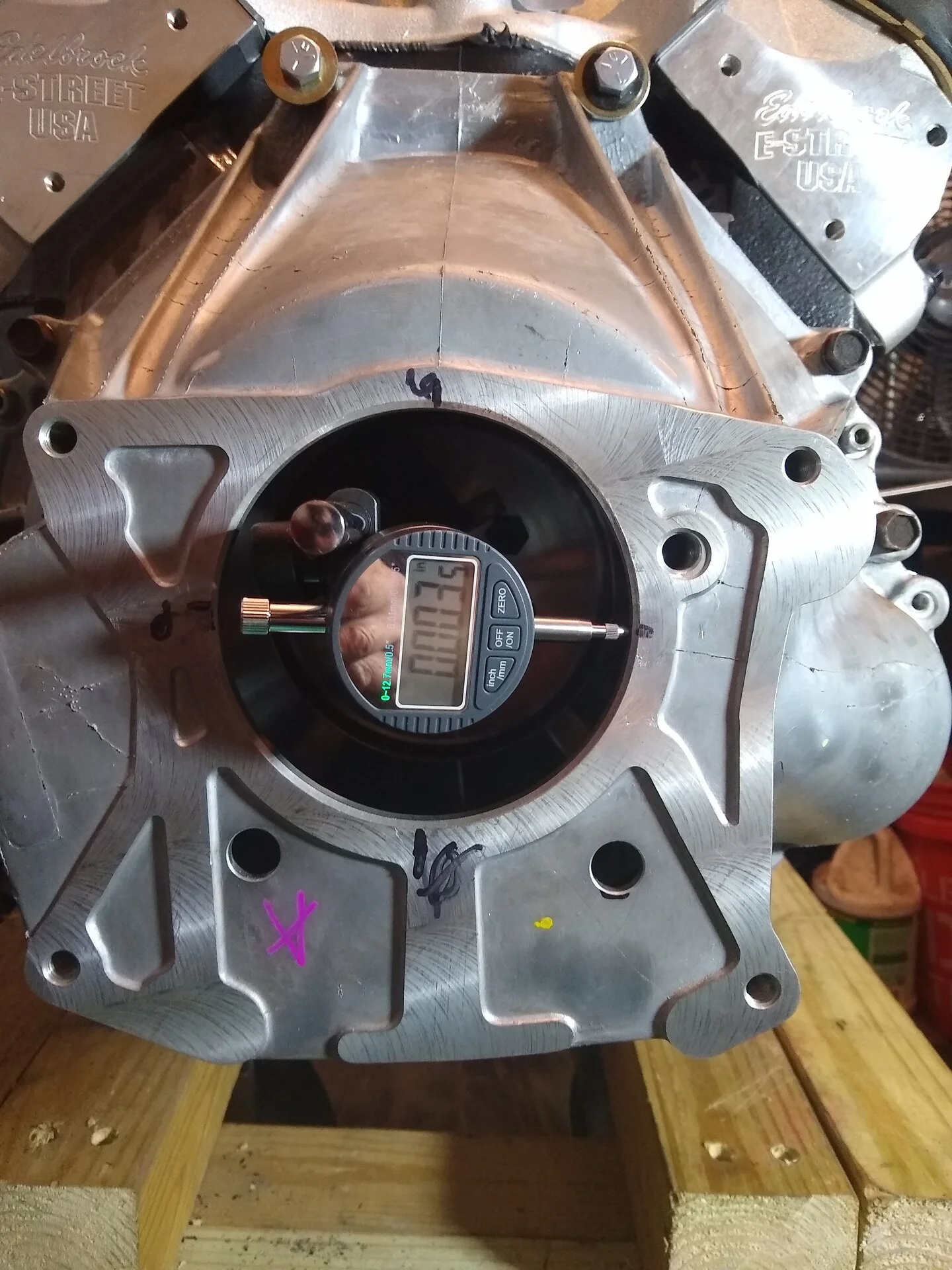

I hope you did the bellhousing alignment check plus put the correct amount of spacers behind the slave if using a hydraulic clutch.

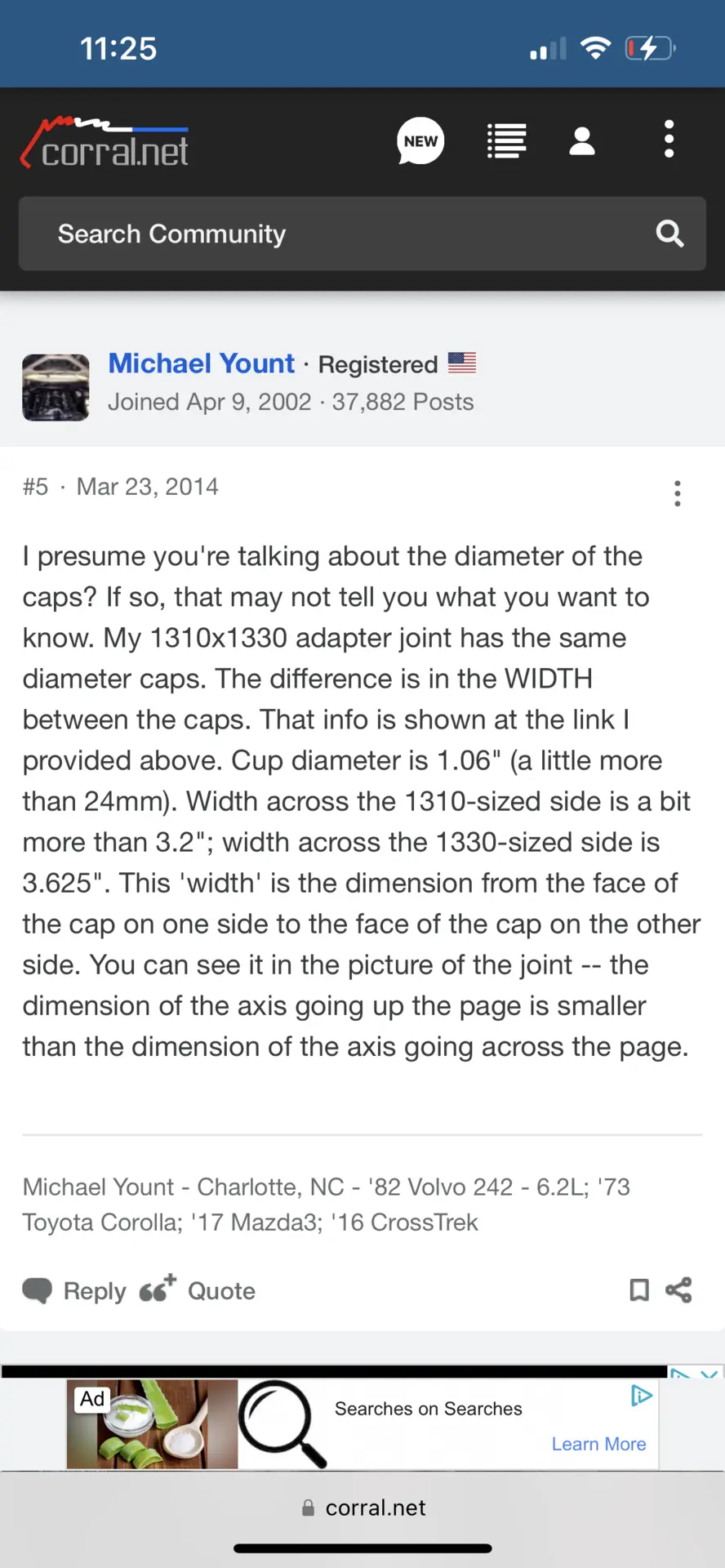

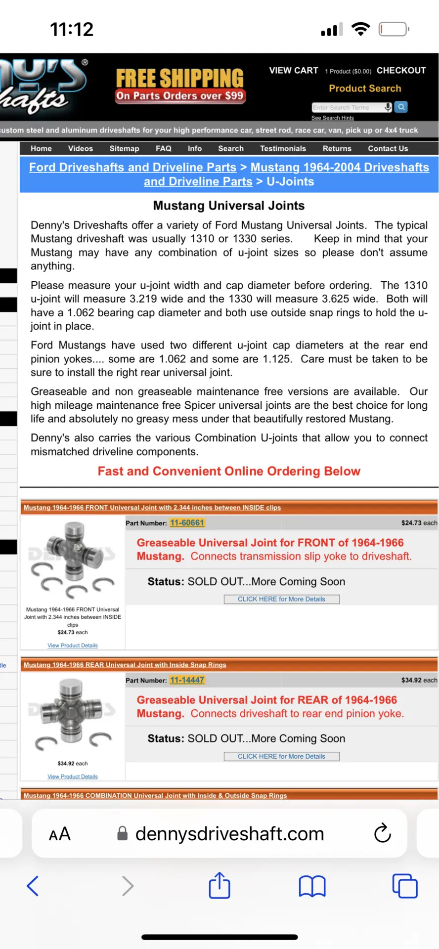

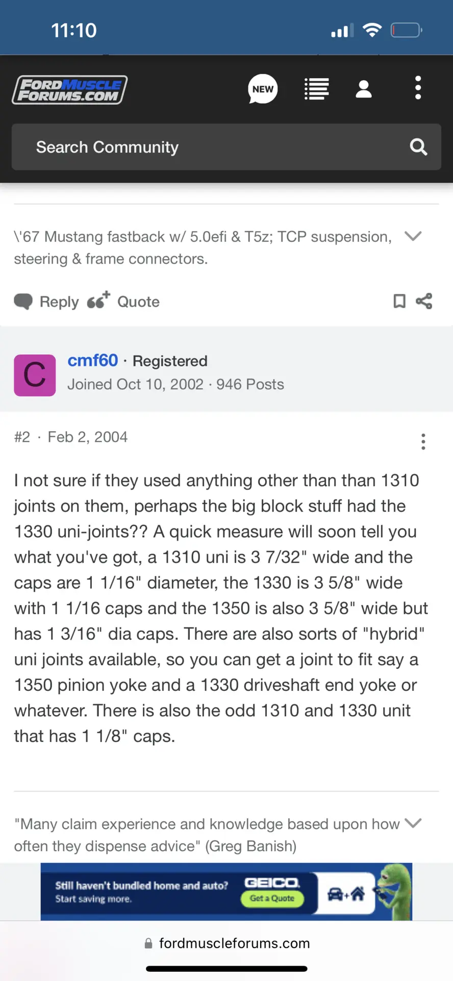

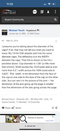

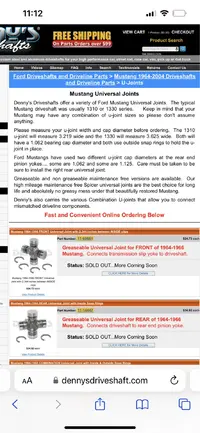

Ok. Thought I’d share what I found . The stock manual u joint is a 1330. The stock auto is a 1310. The only difference is the lengths.

That is the info you need to know to figure out what U joints you need..
Try PSTDS.com and click on Drive shafts 101.....Then scroll down....
The info in this section is laid out very clearly and is very helpful...
