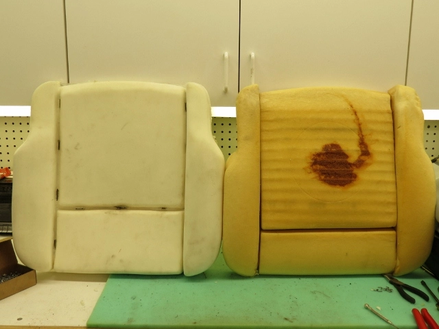

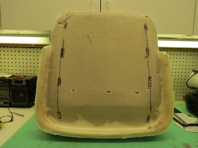

first picture is of the new TMI seat foam that clearly shows the embedded listing "rod" in the three listing pockets and of the original OEM foam (red glue patch and all) .... the front of each seat foam is at the bottom of the picture .... the thing to note here is the lack of embedded lists in the '67 OEM foam and the different size and shape of the TMI sport seat foam ..... as noted in previous posts, the center section of the TMI seat is about 1" narrower than the OEM .... also, note how much more then transverse pocket (front one) sits towrds the back than the OEM ..... all of that means the OEM location of the lists installed to the seat springs (serpentine "loops") will have to be adjusted in order to accept the TMI foam properly ....

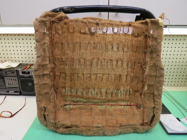

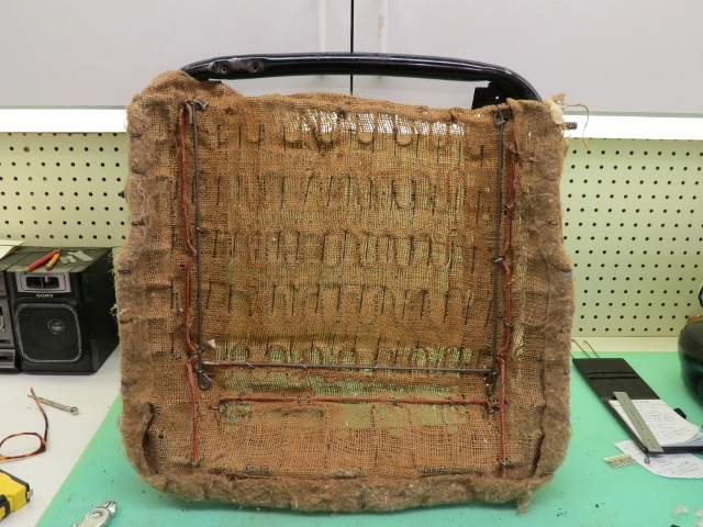

here's is the seat frame with the original burlap, etc. still intact .... the OEM list rods (paper covered) are highlighted with a red marker pen ....

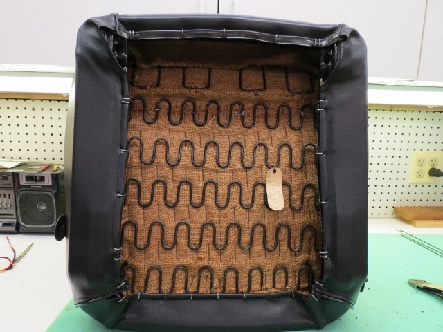

this picture shows the seat frame with new listing rods installed to accommodate the location of the front (transverse) and side listings embedded in the TMI seat foam .... the transverse rod is located about 1 1/2" towards the rear and the sides are each inboard about 1/2" ..... I used 1/8" steel rod to fab these new rods ..... of note, there section of the OEM side lists that go up from the seat to the front edge follow a slope that provides the thigh bolster .... I moved the locations of those two sections for each side inboard a 1/2" so as to align with the newly installed rods on the seat springs .... yes, you could relocate the entire OEM listing rod on each side instead of adding new rods ... perhaps I'll try that on the other seat .... but this approach works .... sure enough, there is variation in the location of the lists across the years .... the point in all of this is to show that you need to check where the new foam lists need to be secured and what it may take to provide those new anchor points ....

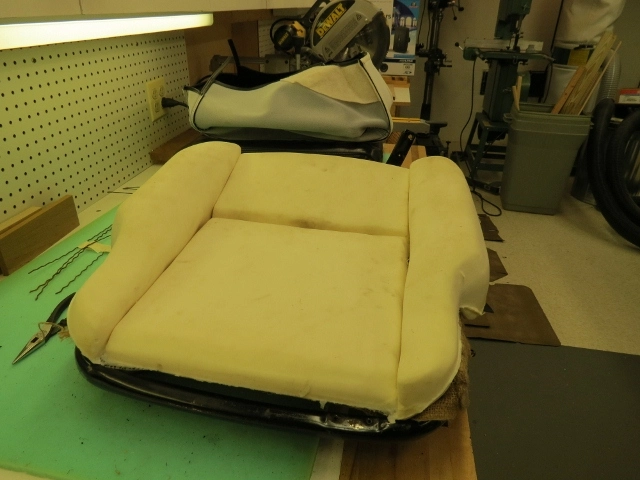

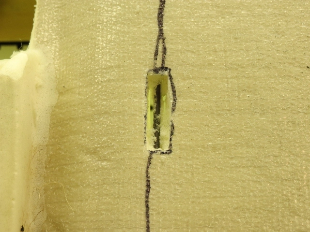

what I did here was to mark the back side of the seat foam to mark the locations of where the embedded lists are exposed on the top-side (see first pic in series) .... these "windows" were then cut out to allow me to see through the hole to aid in ringing the embedded list to the attaching rod on the seat (see second pic) .... I picked up on this tip from an article I found on the web someplace .... and I found this really helped in getting this to work more easily ....
67GTFB
122
Apr 18, 2012
#14
  • Apr 18, 2012
  • #14
next the foam was hog ringed to the seat frame by ringing the embedded rods to the newly installed seat lists -- one ring in each "window" .... picture shows the entire foam anchored to the frame .... if the seat lists have been properly located, the foam lists should be located more or less right above the seat lists .... then all that is required is to push down on the foam rods to ensure the seat rod is engaged when crimping the ring ..... simetimes easier said than done ....

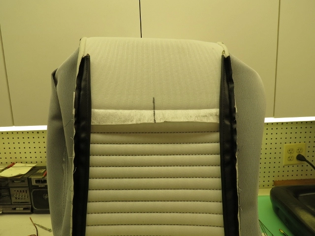

before installing the upholstery, I found it to useful to mark the center of the traverse list pocket (outer edge) as well as the center of seat foam list pocket (front edge all the way down to the bottom of the pocket (or slot or whatever its called) .... this way you can have a reference line to come to when doing that first, all important, ring -- get it centered .... for the TMI upholstery you will have to cut the ens of the traverse pocket loose as it is sewn down with the side pockets ..... cut that about 1/4" (no more) from the outer edge just up to the seam line on the seat ....

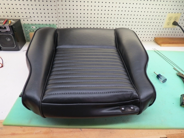

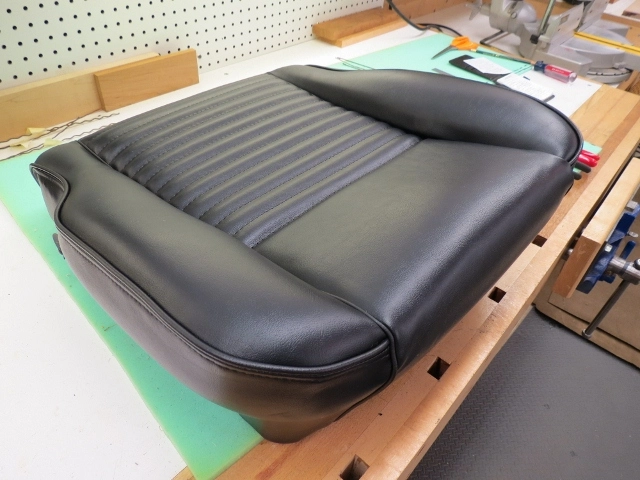

the rest of the story is where "magic" happens and I only have pics of the final results ...... but once you get the first list anchored down, the rest of it should just be a matter of attaching the outer side lists (while ensuring that the corded edges come right to the corner of the foam), then pull the front panel and corners down, followed by the rear corners .... then pull the sides and from down and around the seat bottom frame rails being careful not to rip anything .... I found I had to fab new listings for the outer panels as the OEM lists were either too long or short for use in the TMI list pockets ..... this is where you have to play and tweak and tug and smooth until it all comes out the way you want it to .... I didn't cut holes for the pivots for the seat back until time to ring down the sides -- the fabric stretched nicely over the two pivot rods and didn't poke through .... I started at the front center, finished the center (working towards the outer edge .... then worked both sides starting at the front and working towards the rear ..... then finished up with the rear .... the TMI upholstery did not have a listing wire pocket for the rear panel .... I decided to use a wire there and made an 8" long wire and poked it through the inner sleeve (like what they do when drawing blood), the worked the wire down the sleeve and centered it along the back edge ... I like this better as it takes the stress off of the individual rings attached to the spring loops at the back .... finally added the back rest stop "plate" .... what's left are the slides and adjusters, but those are mundane and not covered here ..... I know this seems like a lot detail for such a small amount work -- but I found that the devil is in the detail ...
anyway, here's a couple of pics of the finished product ... not perfect, but good enough for my purposes .... OBTW, I tested the seat and it IS definitely an improvement over the old OEM stuff ... and is "comfy" to me .... good luck with your projects .... I may post an update when I do the back rest, but will probably spare everyone with all of the bloody details .... cheers -- 67GTFB ...

67GTFB, great job and thanks for posting the pictures and writing up all the detail to explain the process. This should come in handy when I go to do mine. I am very impressed that you don't have any wrinkles, looks very good. And I'm glad to hear you think the sport foam is a dramatic improvement over stock. I want to keep the stock retro look but improve on the comfort, so this should work out good for me. My 68 has seats with the factory headrest option, they essentially look like the 69 seats ( not the high back Mach 1). Last I checked the TMI site, they didn't list this seat for the sport foam. TMI, if you are still following this thread, please let me know which product I should be looking at for my seats..
